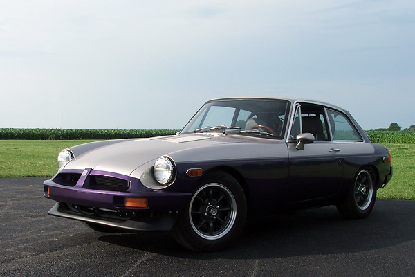

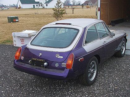

Always wondered why the factory didn't offer this option. Makes the car look more refined and better lines. The second photo was taken in 2006 at Gatlinburg. We were there and I saw this car in the real. It was a beautiful restoration, the car was gorgeous! PJ
Couple examples,

John did the paint and body work of my 1974-1/2 MGB/GT. I requested body-coloured bumpers.
