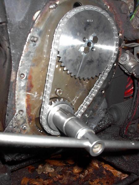

There should be marks on the sprockets, like you may be able to barely see here. IM005739.jpg remove with the aligned in a perfectly straight line and make sure they are the same when you put them back on. You can make your own marks if you don't have them. Ideally at top dead center on piston/cylinder 1, but for purposes of maintaining cam timing only that is not absolutely required.

I understand about the marks on the sprockets, but the procedure in Bently calls to remove both sprockets and chain as an assembly. For the crank there is the key, so it's sprocket can only go on one way, so it's easy to get is lined up correctly. It's when removing/installing the cam sprocket and the cam then turning as a result that I am concerned about. I think that the cam sprocket can go on 2 ways, though I could be wrong. Is there a way to either keep the cam from turning (or is it held by the distributor), or marks on it so you can put its sprocket on the correct way?

It is a good idea to replace the 2 sprockets if you are going to put on a new chain.
You should be able to remove the cam sprocket without moving or rotating anything.
Then before removing the crank sprocket, make your own index marks on the crank and engine plate.
But in reality, I'd do the cam timing procedure and maybe advance it a few but no more than 4 degrees.
glemon
Yes make the marks on the cam sprocket so you are sure it goes back on the same. Neither the crank nor the cam spin very freely in a fully assembled engine, so if you are not working on anything else it is pretty easy to keep them in place.
Replace the timing chain tensioner while you are in there, they are a cheap little strip of spring metal that pushes against the chain. They are known to wear out.
