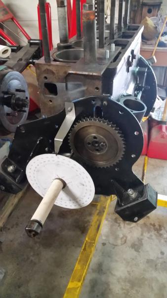

2. Silly question, but I'll ask anyway...is there a way to time the engine without the head on? I bought a new HD chain, cam sprocket and crank sprocket so starting fresh. Figured it might be easier since I can see the crank, camshaft end, cams and the bottom is still open as I had to buy some .005" thrust washers as my crank end float was .014'. <waits for parts>

There is a system called degreeing the cam shaft. (I think that is the term.)
It involves a plate bolted to the top of the block with a screw in it to prevent the N0.1 piston coming to TDC. A degree wheel bolted to the crank shaft and sprung loaded bolts to ride in the No.1 cylinder cams.
I think Macys site has a complete write up.

Interesting...Thanks. I wonder if it's easier to do it this way or just wait till the head is on. I noticed he said that with an aftermarket cam it is worthless to use the factory manual procedure so I'm thinking this would be better. But, I don't really have all the tools to make a plate like that. Hmmmmm...

Timing the valves and timing the ignition are two different things. Both can be done with the head off (using the static timing method).
Most aftermarket camshafts are still symmetrical, meaning you can time them using the workshop manual method. If you bought a performance (non-stock) camshaft, it should have come with a timing card and information on how to time it.
Degree wheels are readily available from any number of vendors, prices vary a lot. I got a plastic one from Moss years ago that worked well enough (until I tried to leave it in place while I drove and melted the plastic).
https://www.mossmotors.com/Shop/ViewProducts.aspx?PlateIndexID=32555&SortOrder=10
I replaced it with a larger metal one from Crane Cams that was only $15 or so (probably twice that today). Or, with just a little bit of computer savvy, you can draw one and print it, then paste the printed page to a sheet of cardboard or thin plastic and make your own.
The TDC plate is just a piece of steel with some holes poked in it. I can't quite imagine not having a drill; but if you don't, maybe you should consider buying one. I got one of those "20v max" Li-ion ones from DeWalt as a birthday present last year, and I really like it. But even a cheap corded drill will do the job.
But IMO all of that is not necessary. The factory timing marks may not be perfect, but they are close enough for the job. It ain't rocket science; for a street engine a few degrees just isn't going to make much difference. And unless you've fitted an expensive aftermarket timing gear, valve timing adjustments are only available in (approx) 4 degree steps anyway.
And you can always go back and redo it later.
PS, my experience has been that the lifters move easily enough that no extra spring is needed. Just the light spring in the dial indicator, plus gravity, is enough to hold the lifter down against the cam. But you can always push lightly on the indicator stem to be sure the lifter is all the way down.

Great. Thanks for the feedback Randall. I definitely have a drill...too many to be honest! HAHA The plate should be easy to make an what's another trip to the hardware store for material. They know me all too well! But like you mentioned, I was just going to drop the lifters down and put the rods down in and put my dial on top of those. Or buy some cheap pieces of aluminum rod to use with a flat surface. Would rather get the bottom timed before putting the head on. Why? I don't know. Like you said, it ain't rocket science but I'm thinking like it is. Being overly cautious. Kind of like the piston sleeves that have to be proud .003-.005. C'mon...these engines can't be THAT sensitive. But...I'm close!
