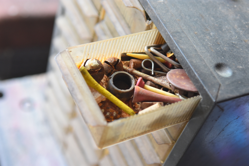

As for tees, I'm obviously remiss in my restocking duties. This bin of bits was sat on my bench when a water heater line let go, it wasn't the most important thing there to quickly get removed, but the only drawer to get water in it was this one. BTW, this little cabinet is only slightly younger than I am.
