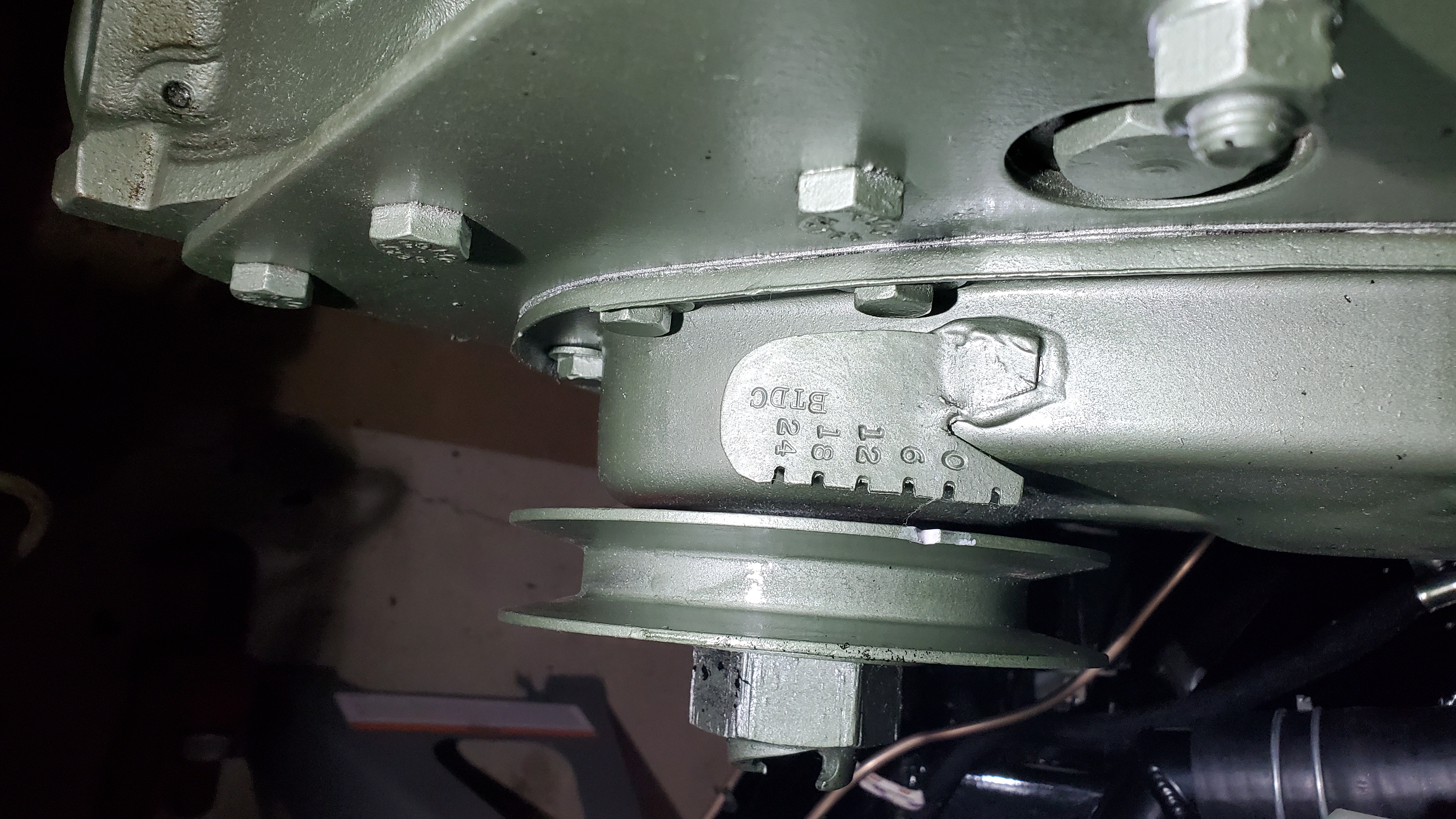

I made one and had to file notches in the pully for TDC. Calculation is simple, just measure diameter of the pully. But, as Greg states, we don't need it anymore.

Very nice job. For the last 25 years I have been just eye balling about 1/2 “ give or take about a 32nd of an inch. Just thought they could have made it easier on me.😁
