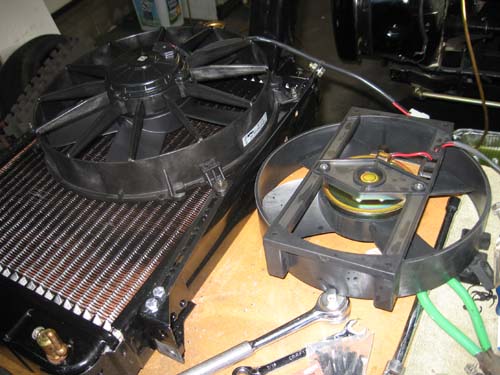

12" is about as big as you can attach to the TR3 radiator. Of course, there are 12" fans, and then there are 12" fans. When I went to replace the inadequate 10" fan on my TR3 (I have no engine driven fan), I ran into a lot 12" fans with wildly differing cfm outputs. I settled on one that puts out about 1600 cfm, which is quite a bit. I only found one 12" fan that put out more, but the amperage draw was more then I wanted to deal with. As it is, the Spal fan I bought draws about 15 amps while running.
Below is a pic of the 12" Spal that I installed, and the 10" unknown that I took off.
