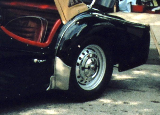

Don Elliott
Paul - In 1990 as I was finishing my 1958 TR3A, I had the larger stone guards chromed along with all the other items. But I didn't want them shiny like a bumper so he buffed the chrome so they look just like aluminium. It's called "dull chrome". They have been on for 20 years and have a few tiny pit marks. They stay nice because the chrome is harder than the base aluminium so it resists chipping and dents better. When I clean them, I clean them like other chrome items and they will never become black as when you try to shine up aluminium parts once you are through the anodized surfaces.
Here's how they looked after 18 years and 94,000 miles in 2007 at VTR, Valley Forge PA.
