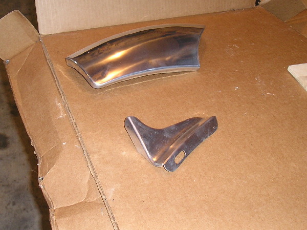

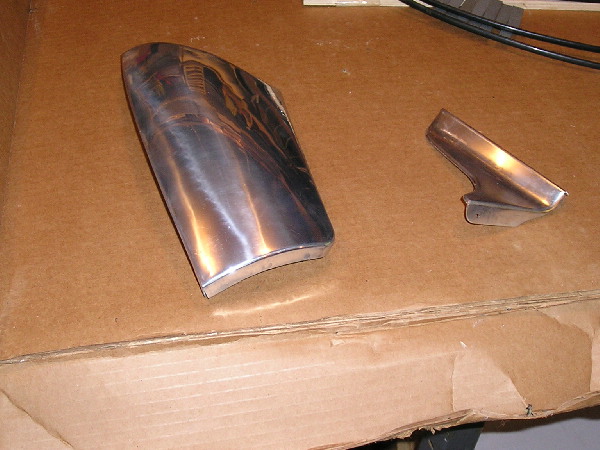

Getting ready to install the rear wings, and have a bunch of neat tips on the beadig saved from a previous thread. But have no information in my archives on the stone guards.
Any tips, don't do's and any suggestions would be very appreciated. I have previously, bought a very nice set of NOS stone guards on ebay. At the going rate for a reproduction set I don't want to mess these up. Both pieces have an apparent screw hole in them, what type of screw does it take? Flat head, Pan head, round head, etc., etc.
I have included two pictures so click on the appropriate area to see the second one, if it isn't in the post.
As always thanks for the help!
Tinkerman

When I took TS13571L apart, it had two oval-head screws holding the smaller pieces to the body. Same screws that hold most of the interior panels in place; plus appeared to be original paint only under the stoneguards; so I believe they were original. The larger pieces had no screws at all, only crimped to the fender. Click on the thumbnails below for large photos.

I had similar screws on my TR3 when I took it to bits.
Having original old stock will make the job so much easier than with the repro ones that need a lot of re-shaping to get them to fit.
As far as I remember the larger guard has tabs that bend around the edge of the wing.
Yours are lovely and shiny!
