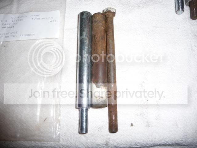

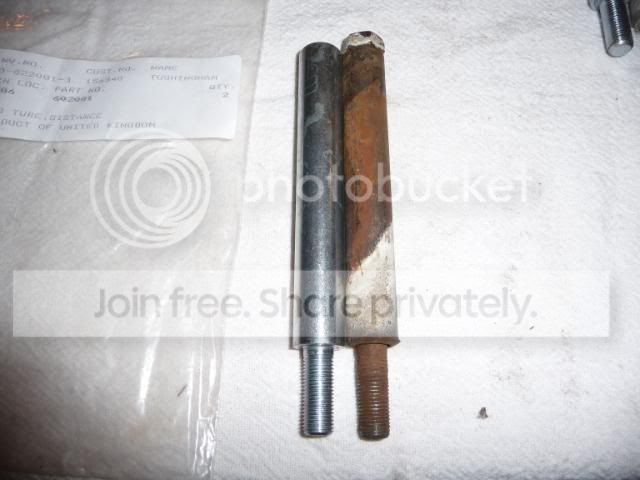

I have purchased distance tubes from TRF some time ago and finally dug them out of the parts stash. They are completely different from what I pulled off my car but I can see how they would work if I were to use them . Looks like my PO made a "custom" solution to fit the bumpers and fabricated his own distance tubes but I want to be sure.
Here are some photos for comparison.
Distance Tubes from TRF
VS what I pulled out of the car
The top of the new distance tubes are threaded.
Does it look like I have the right part?

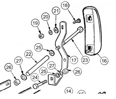

Your old ones look like the ones on all my 3As, as well as what is shown in the SPC. The TRF part appears to be an "improved" design.

Should work though Randall wouldn't you agree with a short bolt threaded into the top through the bracket?

It also seems very unlike TRF to sell an "improved" part under the original part number. I'm guessing that their supplier made the change without TRF's knowledge. Likely if you want to return them, they would supply the "proper" parts.
But it looks like what you have should work fine, and the change will be invisible.

Interesting ... I received a new distance tube for Christmas and it was the same as the ones you have Tush. What I ordered was one long bolt and one distance tube (from Moss) so I'd have a set (as I have one original). Still don't have two the same although I'm guessing it would work fine. I agree, why change a simple system that seems to work fine to a more complex one. If you plan to use the "new" ones Tush, I'd be interested in the old style tube if you want to part with it. Cheers, Mike

So I wonder if you order bolt number 23 do you get a short bolt now to match the modified distance tube?

Usually if you have a rusted car or live in an area where salt is used the bolt is rusted into the tube and is impossible to remove without cutting the bolt.The new design is far superior and easier to install.Small adjustments are able to be made if the mounting holes on the frame are enlarged.

Well from Moss I got the long bolt and the new-style distance tube ... not a very useful combination :smile: Cheers, Mike

If you use the new improved design and you find that the top of the bumperette is out too far from the rear valance body-work, you will have to take a hacksaw and shorten the top end which may also involve drilling and tapping the threads deeper. The original two-piece design lets you shorten the tube and this won't show if that cut end is hidden below. Also if you want to add flat washers to the internal long bolt of the original design, this will tilt the top of the bumperette out further from the body-work if needed.
