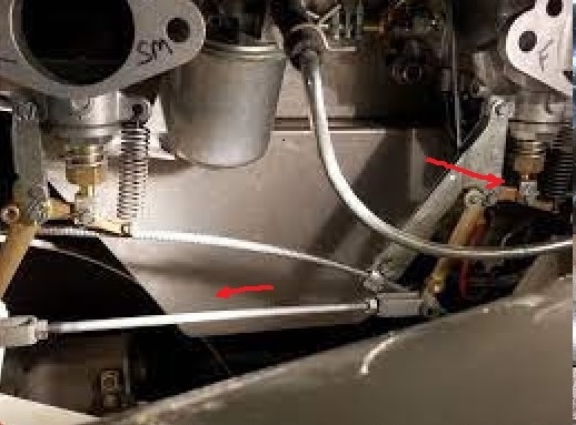

Try this: Reach down under the carbs and pull the choke link rod between the two carbs backward. Watch the levers that pull the jets down. They should move a quarter inch or more. Then see if they move the same distance by pulling the choke cable. That may take a helper. If you get the jets to go down, hold them that way with the cable. Use grips if you don't have a cable lock on the choke knob (turns to the right).
Try the starter that way.

...pull the choke link rod between the two carbs backward...
Tom, you sure that's correct?
Pulling the cable would be pulling the cable forward.
Pushing the cable would be pushing the cable backward.
Either way I couldn't get the jets to move down.

TomMull
Sorry, perhaps a picture would help.
You would be operating the choke and ignoring the cable. Pull the rod, left arrow, back. The lever, right arrow should move the jet down 1/4 inch or more.
Here is the link from this forum for the picture: Choke mechanism

Tom,
Thanks for the clarification and the picture.
That makes sense.
