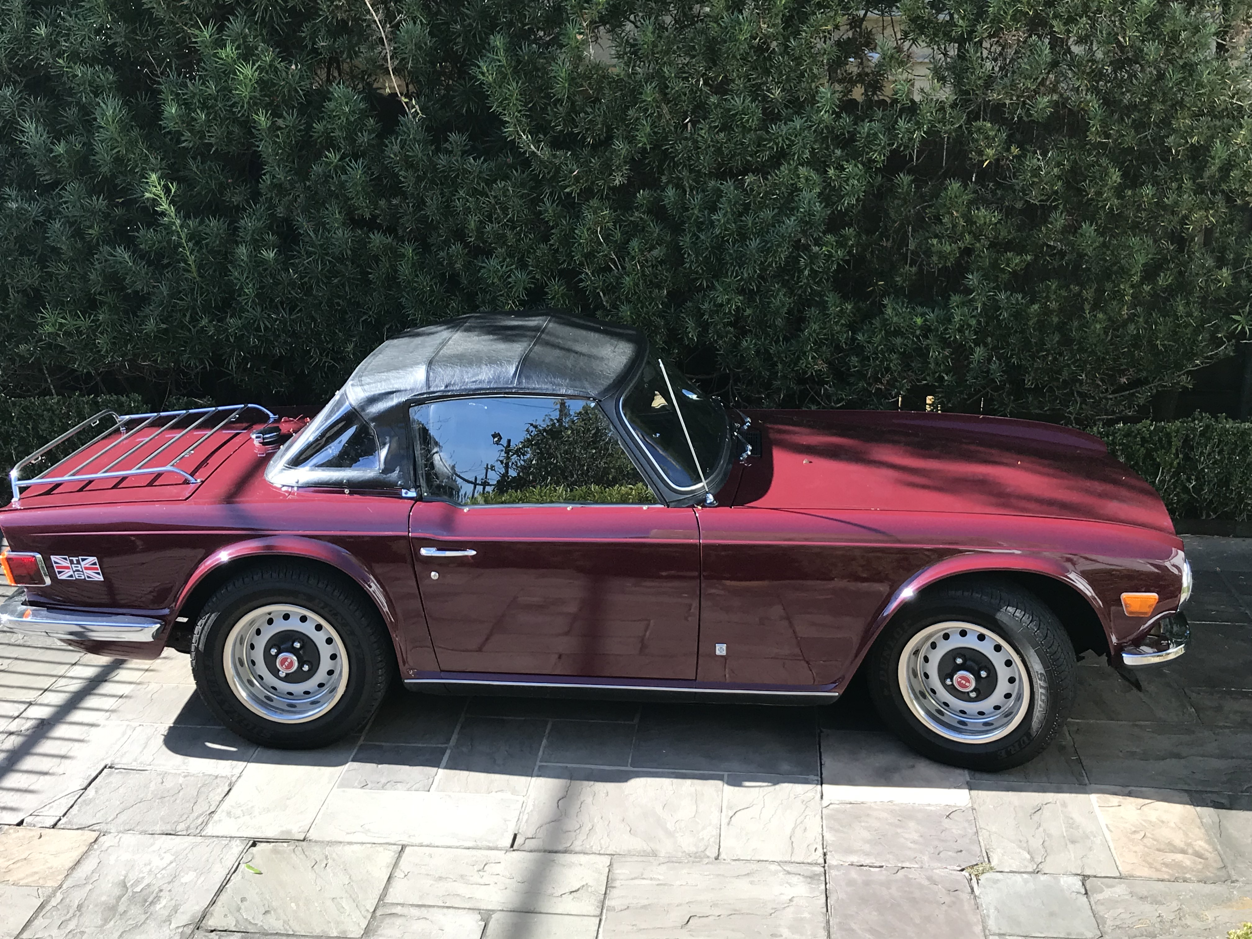

Hey fellas,
Wanted to say hello!
Recently came into possession of a 1972 TR6. Appears to be in great driver shape. No real history behind it (bought off my stepfather who bought it on an impulse buy…go figure).
Apart from having a specialized mechanic look it over, anything I should be preparing for?
Off the bat, I’d like to redo the wiring, update the suspension, and dive into this engine.
Already sent off for the key numbers as I need to get some made.
This will be second vintage car (first one was a 1985 K5 Chevy Blazer…miss her).
This will be great in South Florida. Only have a dog to worry about so I have some time.
