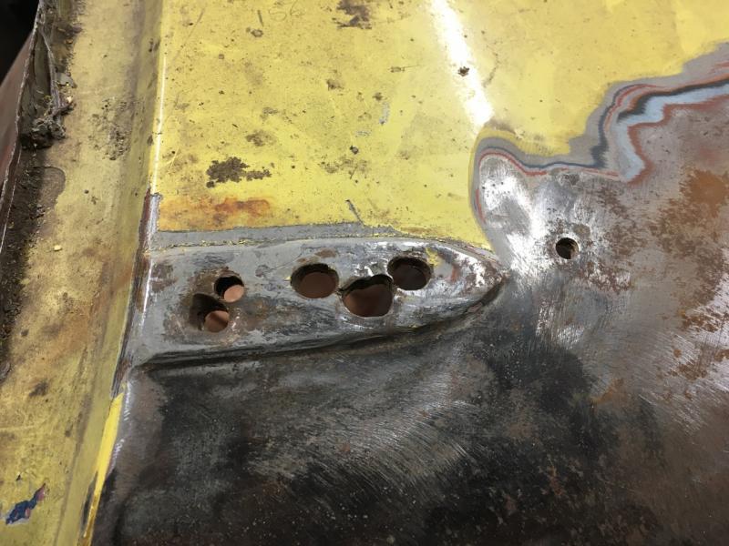

Time to start the scuttle repair. The PO was not very kind to this area.
passenger plinth damage.jpg Passenger side raised plinth damage.

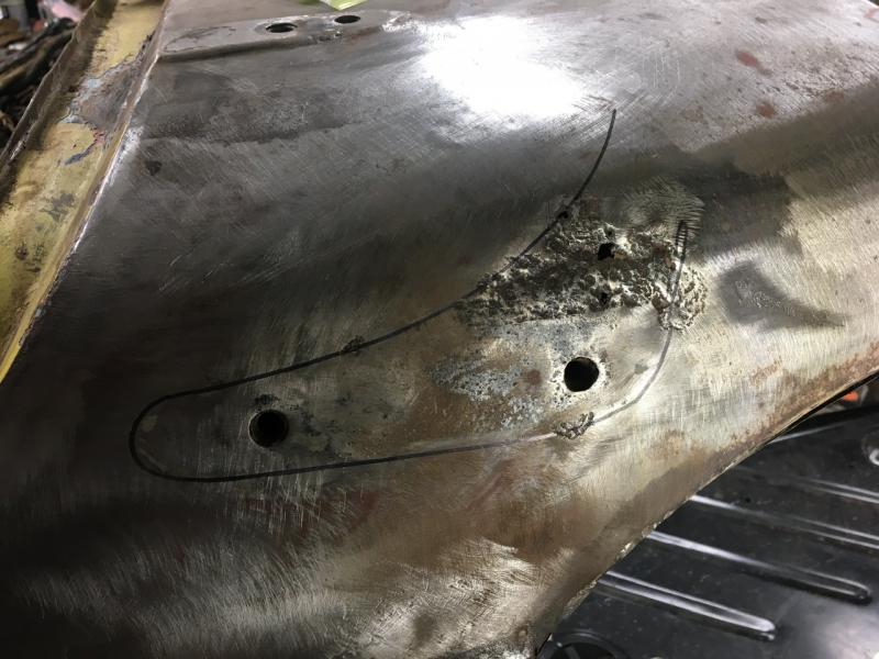

This is the plinth support bracket. It needed to be removed to do all the repairs.

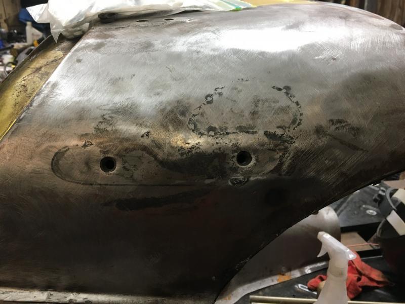

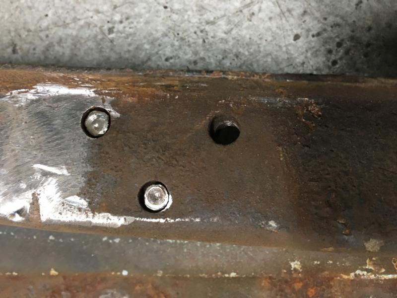

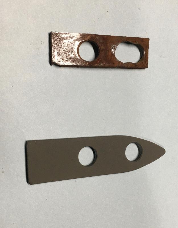

The raised plinth has a steel spacer between the plinth and the support bracket underneath. The spacer is 1/8" (.125") thick.
This shows the original and the one I made. I made the new one a little larger for additional support. Maybe I was over thinking this.

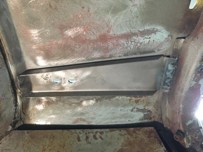

passenger side plinth reinforcement spot welded inside.jpg This picture is a little deceiving.This is the underside view. The new plinth spacer is plug welded in the recess of the plinth from above. This area has a coat of self etching primer and a coat of cold galvanizing primer before the support bracket gets welded in. Could not get rid of double picture.
passenger side plinth reinforcement spot welded inside.jpgpassenger side scuttle support brace welded back in.jpg
The support bracket has been repaired and welded in. Between the bonnet hinge mounting holes is a plug weld to the plinth spacer just like the top side. Originally this was spot welded with a single spot weld between the mounting holes
I don't have a giant spot welder like they did so plug welds will do.

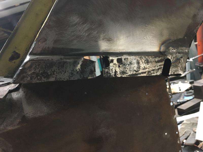

driver plinth damage.jpg Driver side raised plinth damage.
driver plinth spacer plug weld.jpg Driver side raised plinth ready to plug weld spacer in place.
driver scuttle support bracket.jpg Driver side support bracket repaired.

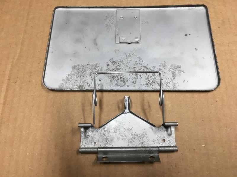

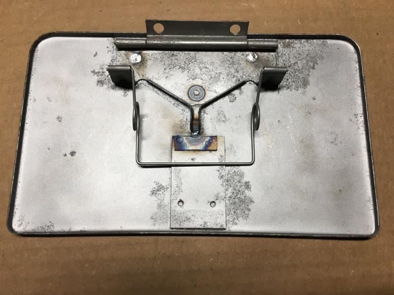

scuttle vent cover damage.jpg Scuttle vent cover with broken lift bracket.
scuttle vent cover repaired.jpg scuttle vent cover repaired. Frank

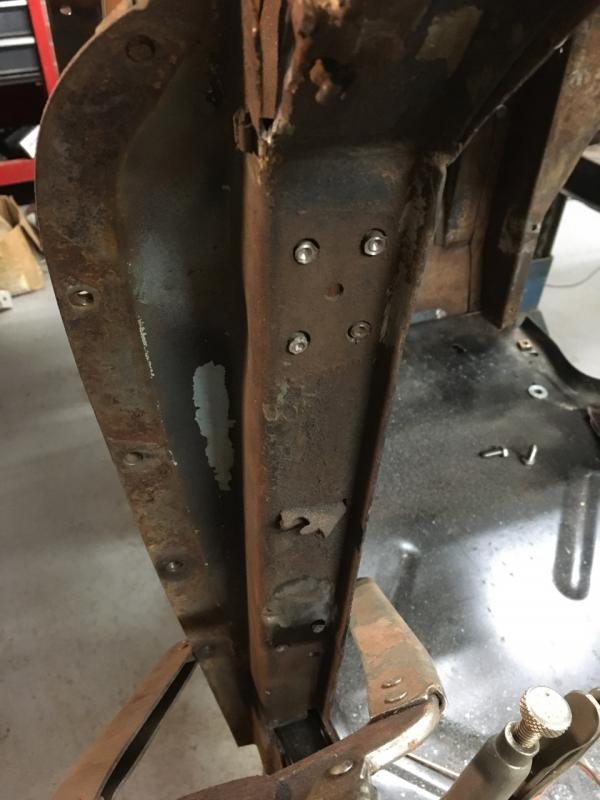

driver side A post damage.jpgDriver side A post damage.

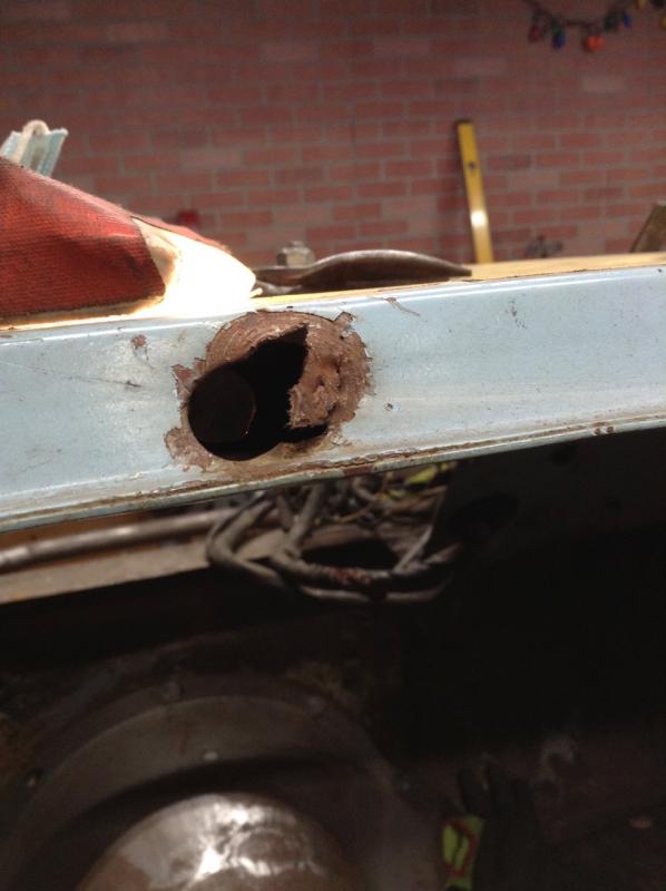

driver side lower scuttle damage.jpg Driver side lower scuttle damage. cracked from the middle of the back slot up to the radius and across to where the scuttle meets the A post. The front of the front slot has been ground paper thin.
driver side lower scuttle repair at the back slot.jpg The crack at the rear slot has been welded and the paper thin area at the front slot has been removed. This is the process to decide the repair method for the front slot. I believe I am going to reproduce the entire slot and cut the entire slot out and weld in the repair piece.

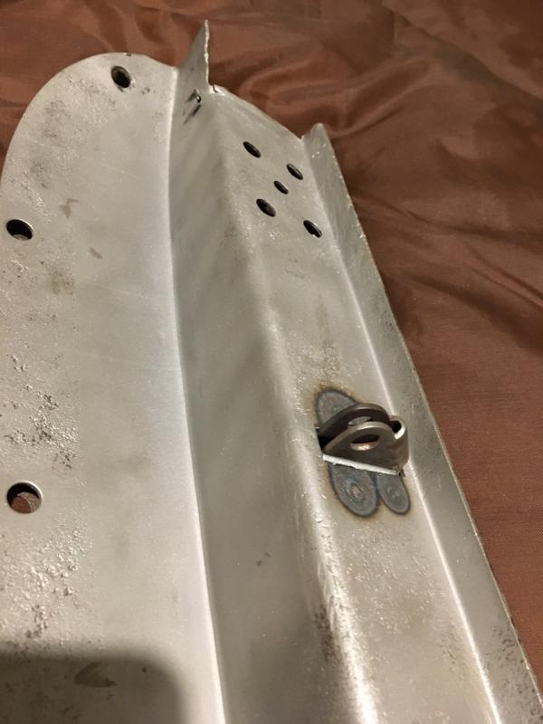

driver side check strap damage.jpg Check strap bracket damage. This is spot welded in and will be removed. A new one that I have already made will be spot welded in.

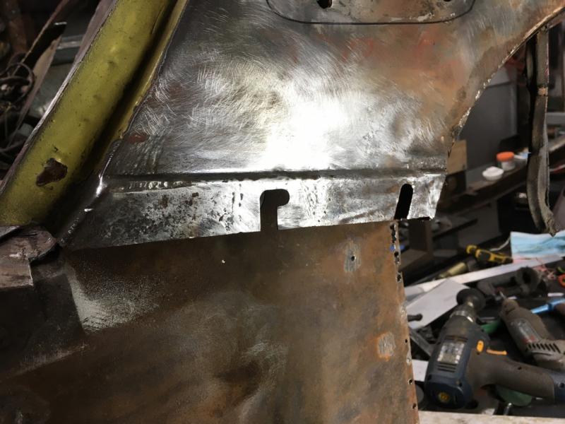

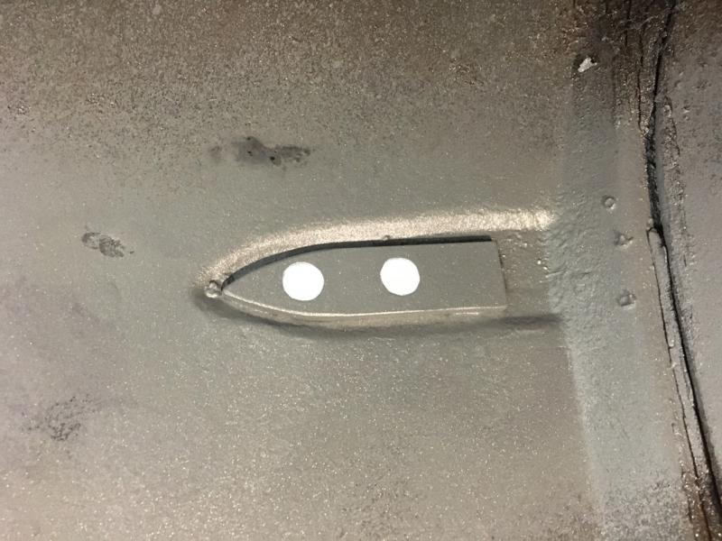

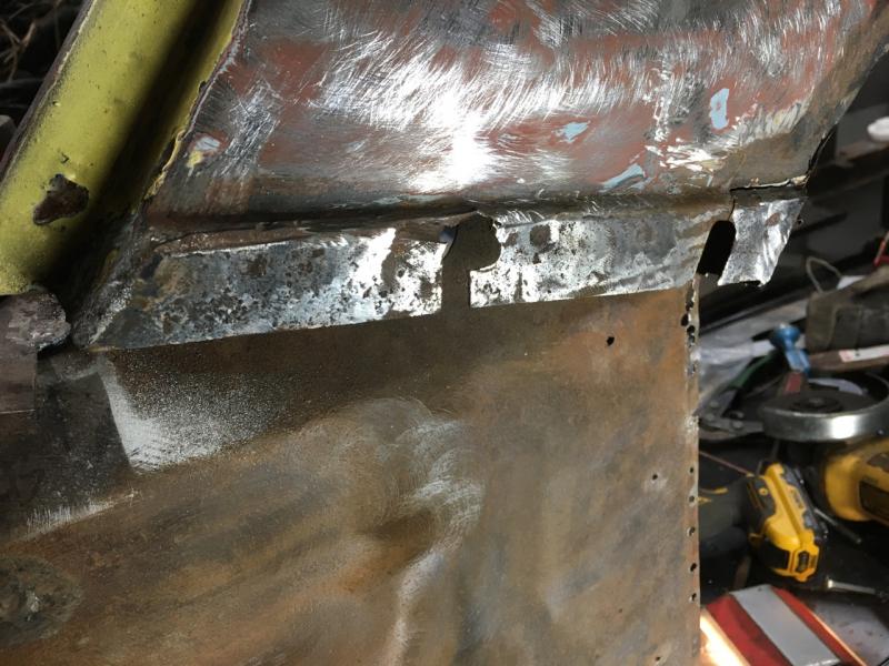

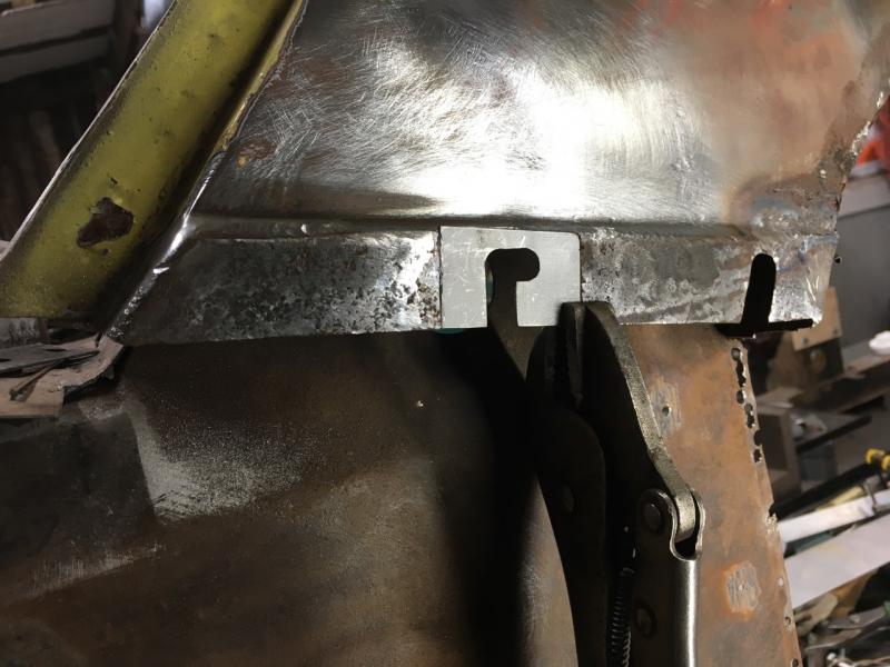

driver side lower scuttle repair.jpg Driver side lower scuttle. L shaped slot cut out and ready to be welded.
driver lower scuttle repaired.jpg Driver side welded and finished.

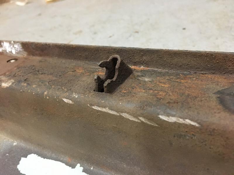

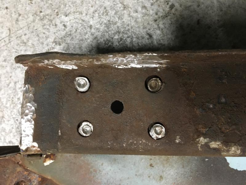

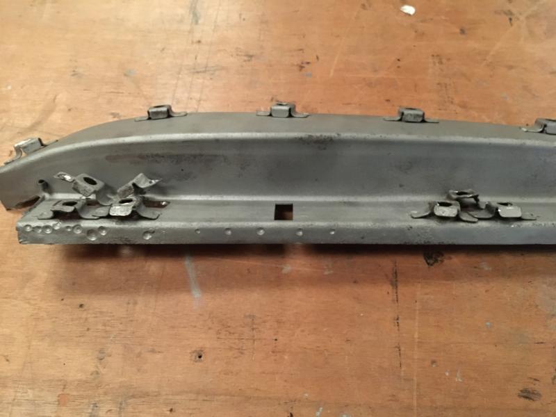

driver side A post cage nuts removed.jpg Driver side A post with cage nuts removed. To remove the 2 inner cage nuts at the top you have to drill out one spot weld on each one to get the nuts out. The inner one at the bottom can be gotten out with a little fiddling to get the flap opened up but it does not have to be drilled. The check strap bracket has been removed. 4 spot welds get drilled from the back side.

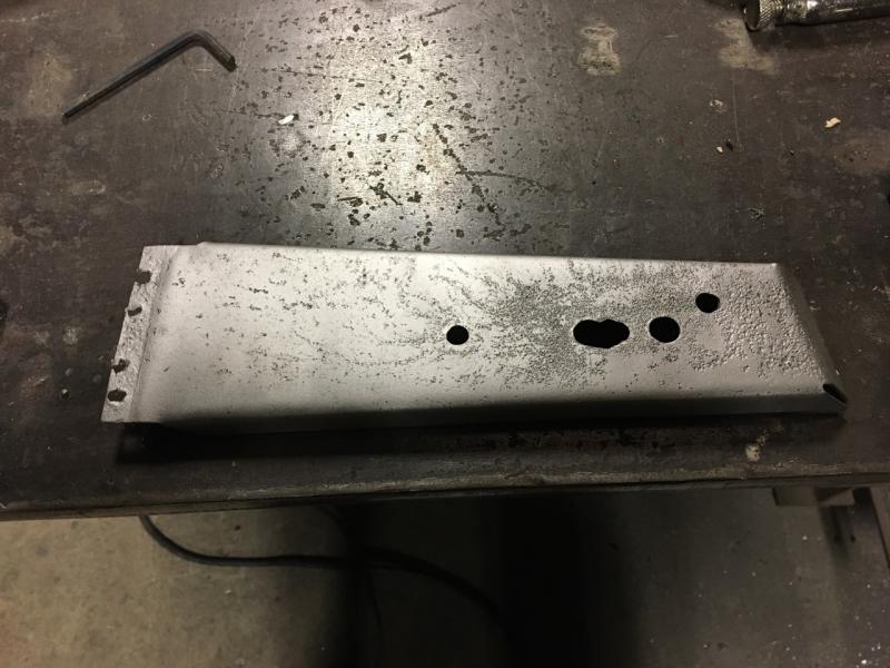

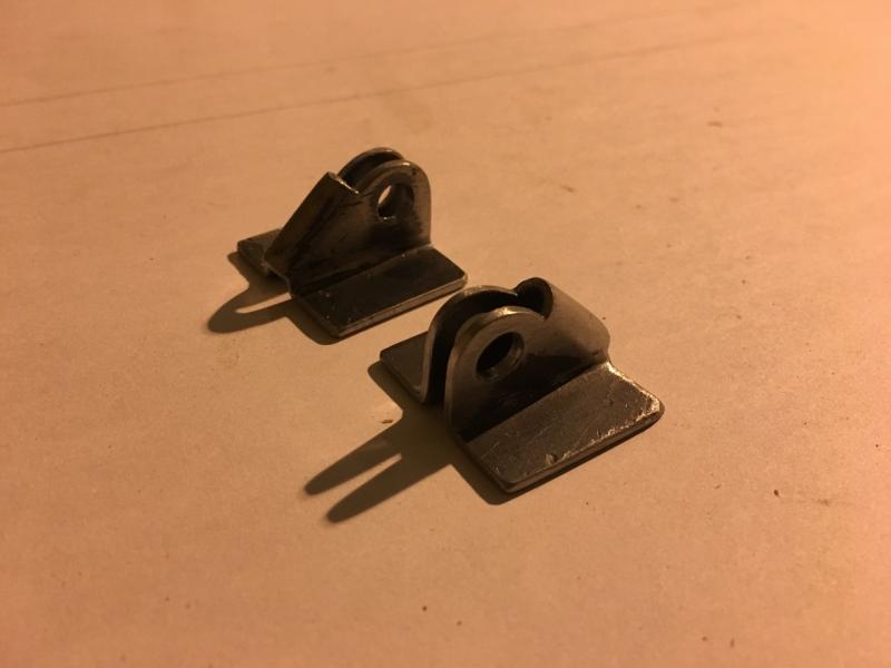

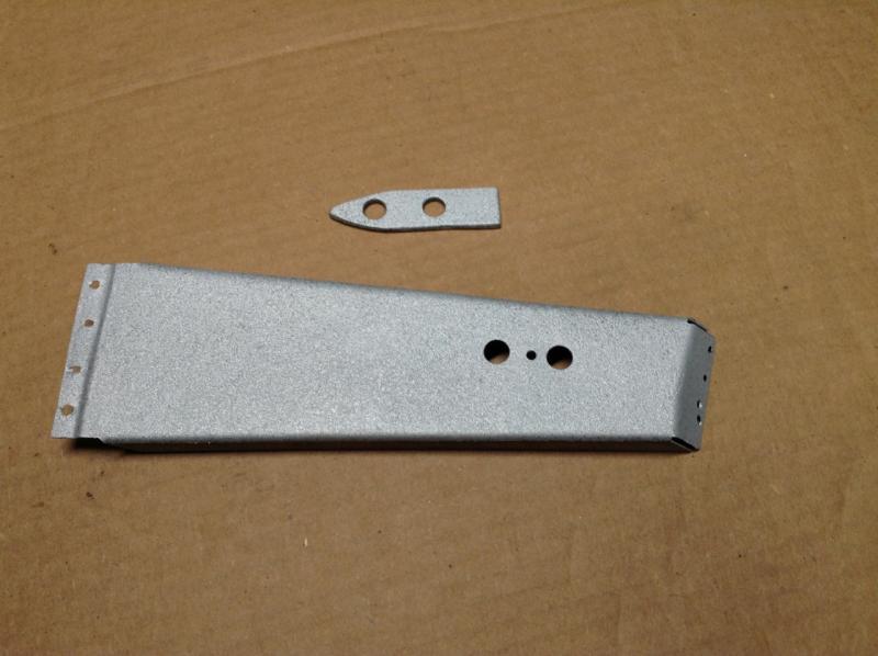

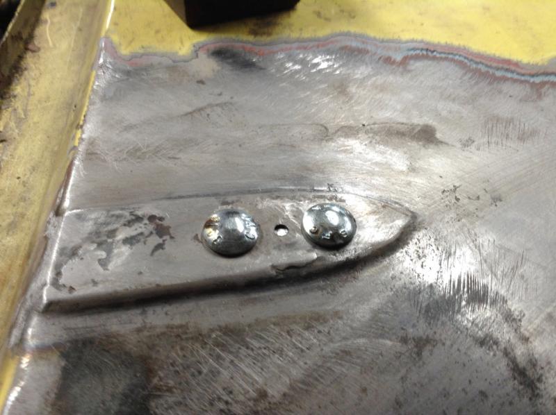

IMG_0149.jpg This is my favorite bracket to form up so far. It is a difficult bracket to form due to its shape. I formed the new brackets out of a little heavier sheet metal. This is a difficult bracket to replace once the car is finished. Hope i never have to replace these.
driver side A post check strap bracket.jpg Check strap bracket spot welded, good as new.

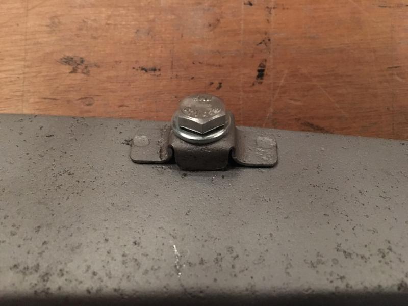

cage nut forming process.jpg This is how I close up the cage nuts. Once the nut is in the cage I thread a bolt and washer in from the back side and tighten the bolt up. this supports the back of the cage as the flap is hammered down slightly then you can finish forming the flap with a pair of vice grips to form the cage around the nut. One thing to mention that modern day nuts are not as big as they used to be. I made all my new nuts to match the size of the originals. The originals are 1/2" x 1/2" x .200" thick. I cut mine out of 1/2" square stainless bar then drilled and tapped them. It may have been over kill at first but has payed off being able to keep the original cages.

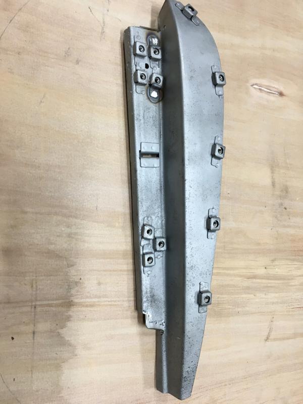

driver side A post repaired new cage nuts installed.jpg Driver side A post repaired and ready to go back on the car.
I have clamped the A post back in place and taken some time to re check some measurements, the front wings have been on and off a couple of more times. I thought I had a problem with the driver side wing. Front to back location is very good the vertical fit is a little snug at the bottom but the bottom mounting flange is new and with a little adjustment I think it will loosen up like the passenger side. All and all I am encouraged that things are lining up well enough that as it starts to be tacked and welded I will be able to make minor adjustments with out having to rework parts. Frank

I did find the cages you get from the usual suppliers need some work so the nuts will not fall out. Wish I had made my own nuts when I was at that stage. SS is a good choice and the Next rebuilder in 2050 will thank you.

Well done with the check strap bracket and the hinge mount captives, I purchased a replacement A pillar from Moss but I had to return it. It was so poorly made i couldn't even mount one hinge, no matter how hard I tried nothing would line up and the check strap mount didn't look anything like the original. I made a template for the check strap mount and repaired the rest of my original A pillar, keep up the good work
Graham
F
Frank Canale
Thank you, Graham. I thought it would be easy, I did exactly what you did. Flattened the original cut out a blank and then realized it is hard to hold and form. I struggled with the first one and wasn't happy with it so I made a forming die and made for good parts. Nice that you have included the dimensions for others to use in the future. Frank
CJD
If I had to do it again...I would go to you for the parts. I swear you are fabbing them from scrap much better than what is available out there! Also impressed with your speed. Once you get to work you really crank.

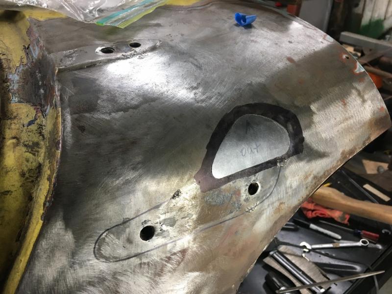

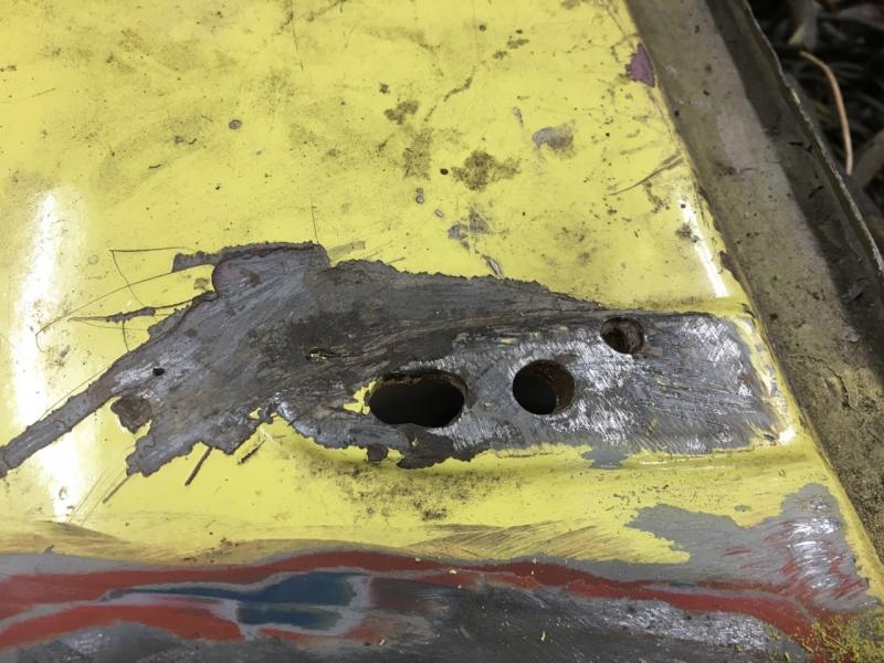

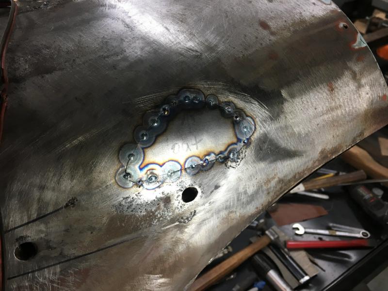

5D3E53E5-D365-462F-8278-139BAE91F37F.jpg Driver side scuttle damage.
15CEF6C1-847B-4D24-A957-6D1170D4F85B.jpg Damage cut out, repair patch fitted ready to tack in place.
310EAD4D-43EA-4336-A39A-86976B060BA2.jpg Patch tacked ready to weld and finish.
AA250286-F518-4B1D-899A-6F6336D6B661.jpg Patch welded and finished. Still a little bit of hammer and dolly work as the repair is a touch low and will need to be stretched to raise it. This is slow because access is very limited to the back side. I had to make a dolly out of 1/4” bar to reach in between the scuttle and inner side wall. Frank
