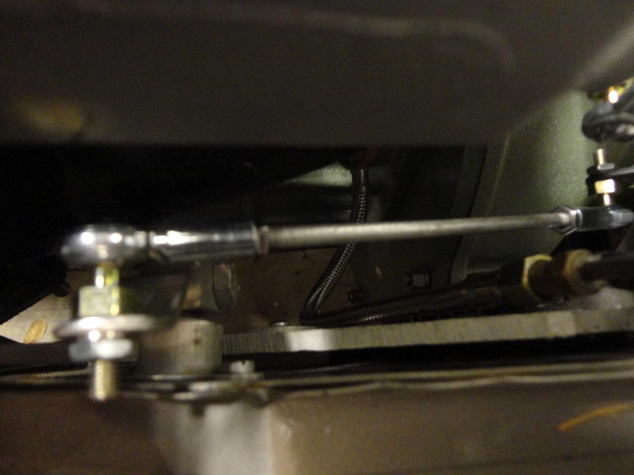

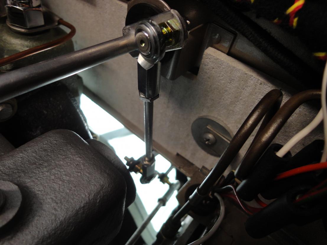

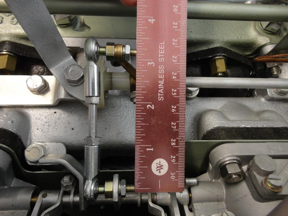

I purchased reproductions and they appear to have as much slop if not more than my original ones. I decided to purchase the "rod end" style from Toms Imports and the slop is gone. Be sure that when you remove the old linkage to measure the "center point to point" of the linkage. It'll make reinstalling them a lot easier because your linkage pivot points will all line up.

The Tom's parts are longer than the originals - will require shortening/rethreading the rods in order to maintain the same position.
Patrick67BJ8
That's why I mentioned making sure you get the center to center measurement. Tom can also help with this and he also has stainless steel threaded rod if you want to go that way. I would post pics of completed modification but I haven't had much sucess doing so with the new improved changes to the BCF.

Here are some photos...finally.
