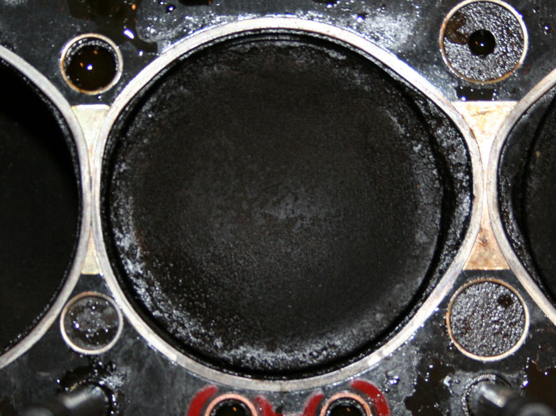

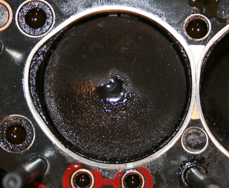

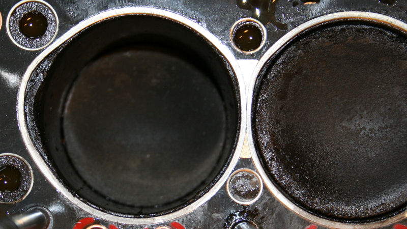

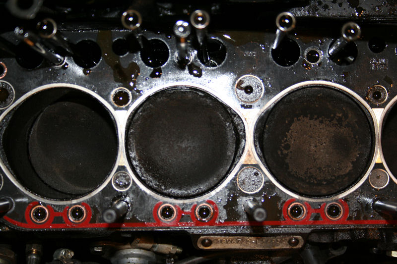

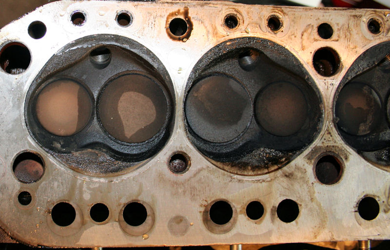

Made the time and got it off.

Stewart, It looks like you need a complete overhaul. How many miles on it? If you do an overhaul It might need to be boared out. New pistons cost just as much for .040+ over as .020-.030. If you want more CC's go .040+ over. You should have the machine shop check your crankshaft, it will most likly be warn and you will need it to be machined. Also the cam shafts on 70's B's were soft and you should replace it. Now is the time to go with a better ground cam and get better gas milage and more power. You will also need new lifters and push rods. Also on the head, the valves and seats were made for leaded gas and need to be replaced with harder ones for unleaded. The valve guides need to be replaced and the rocker arm shaft and bushings. You need to make sure the head is flat - - have the machine show check it. Sooo your looking at $2,000 or more - - that's about what I put into my 72. If your going to do IT - - Do IT right the first time, I didn't and regret it. I should have gone .040 over on the bore and only went .030, I wished I had gone with a better camshaft.

I'm debating what I want to do. Engine has been rebuilt at some point and the car has 105k on it. I had the head rebuilt 1500 miles ago after the previous one cracked along with a new clutch, 270 cam and lifters. Bearings at the time were good pistons are marked with .25 and have a part number that doesn't match anything so I left them alone as the compression was decent. I regret that now.
Now that I know what happened and I'm fairly sure this is going to the machine shop I'll have to decide what I want to do. I've been happy with a mild cam in a stock fresh engine (my 75b) and until today its been a daily driver. I wouldn't mind building a little extra hp but when It's back on the road its still going to be used as a daily so reliability is key.
