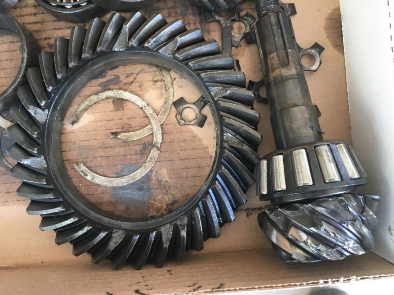

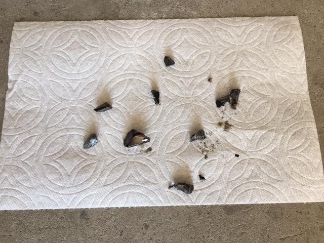

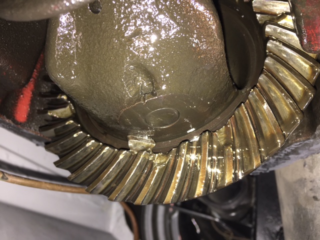

Well, the only thing I didn't rebuild on my TR3A was the rear end. Was 70 miles from home last weekend, headed up to Ironstone Winery in Murphys, CA to a beautiful Coucours d'Elegance.... And it sounded like a leprechaun snuck into my rear end and started pounding his way out with a sledge.
Towed home, put her away, and was hoping for a U-joint failure. Guess it's not my lucky day
So, clearly the ring gear is toast. Can I obtain new guts (or used) and put this thing back together? Or better to just replace it outright with another used rear end? I'd rather obtain a donor rear end and have a differential repair rebuild mine. That would give me a fully rebuild diff and I wouldn't need to worry about it for a while. Also, I'd like to keep this rear end case because I spent the better part of a weekend cleaning and painting this one and I would hate to have to do that again.
Thoughts? Recommendations? I assume the pinion is also trashed so there may not be much to salvage here.
Thanks
Pat

The ring gear and pinion are a matched set, and should be replaced together even if the pinion looks perfect. Obviously you'll want to replace all the bearings and thrust washers, and may very well find more damage on the other gears.
With that much damage, and my experiences both with rebuilding an LBC diff myself and with having a non-LBC rear end rebuilt by so-called professionals; my suggestion would be to look for a good used one from another car.
First of all, you can't "just put it back together". Clearances and preloads have to be checked, shims replaced and changed multiple times, and several unobtanium tools are involved. Read through the manual section, and check out the slides at
https://s258.photobucket.com/user/TR3driver/library/Stag diff to see part of the process. (Obviously that's an IRS diff, but the differential portion of a TR3 axle is exactly the same. I've got a TR3 axle apart but haven't tackled putting it back together yet, so no photos of that.) But for some odd reason, I missed taking photos of the process for setting the pinion preload, which involves pressing the head bearing onto the shaft, doing a trial assembly, measuring the torque to turn the pinion (should be 15 to 18 INCH-pounds), then taking it all back apart and trying a different combination of shims. Because the new bearings were slightly different than the old ones, I went through that process something like 20 times before finally getting it right. Oh yeah, it's really tough to get the head bearing off without ruining the shims, so I went through a lot of shims, too.
And there may be damage to the housing that is not visible to the naked eye. Although uncertain, it appears that was the problem with my non-LBC diff that almost set the car on fire (someone saw the flames and called the fire department), and failed again less than 1000 miles after the professional rebuild. Evidently the tubes were no longer in-line with the pumpkin, and the first rebuilder had not checked that.
Uncertain parts quality is another issue. I made the mistake of ordering the "no-name" bearings and discovered that not only were they different thickness than the originals (greatly complicating the shim selection process), they were actually different than each other! (I threw them away and bought Timken. Hopefully I got genuine Timkens, not some of the Chinese fakes that are floating around.)
Plus, chances are that you can pick up a good used rear end for less than the cost of just the R&P set new. The R&P are still available new (which I find amazing), but they sure aren't cheap! By contrast, every single "parts" TR3 that I've come in contact with had an apparently good differential in it. I've got two or three laying around, but unfortunately did not take good care of them, so condition is uncertain.

Bummer. I would not mess with that rear end. Try to imagine the loads placed on the parts as the broken teeth grind between the gears. There are very cheap diffs available that have not been traumatized. I have 2 spares...and would be happy to donate for local pick-up.
If you rebuild the original...all the internal bearings are toast, along with the gears. The chunk needs to be checked for warpage...and it and the center hub need to be magnifluxed. All in all, a new, used dif would be cheaper and less risky.

Update on my rear end problem.:chuncky: Thought you all might like to know how this is going.
I pulled the diff and dropped it at Ring and Pinion Service here in Rancho Cordova (Sacramento). They went through it and told me it was rebuildable. They seem like a great shop and have done some British cars before. I do have a lot of confidence in them. I purchased a new ring and pinion set from Rimmer Bros for about $325 delivered (strong dollar and 15% off sale worked well for me). I was able to obtain all Timken bearings from TRF, along with some shims and pinion seal. All that, with $350 for setting up the new diff and I'll be back on the road in a week or so (I hope). As info, this is about a grand for a rebuilt rear end. I had an opportunity to buy a used rear end for $600 locally and had some offers from others to give me one (with shipping probably at a few hundred dollars). But, I am opting to pay the piper and have what I hope is a solid reliable diff that will outlast me and the car. I sure didn't want to spend the money but now can relax and not worry about it any more. It is the only part of the drive train that didn't get a full rebuild during my restoration.

I think I had a bearing failure that led to a misalignment and caused a tooth to break. Then, all **** broke loose in there. I did have some whining and vibration from some part of the drivetrain before the rear end failed completely. Here is a pic of the pinion gear that they returned to me from the shop.ring pinion trashed.jpg

Which bearing do you think failed? That head bearing looks OK and it's usually the one that takes the most pounding.
All of my failures have been from breaking teeth. Once part of a tooth gets broken off, it quickly does some incredible damage to everything else. When this one happened, I didn't even realize I had a problem until I saw gear oil running down the driveway.
