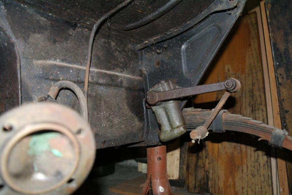

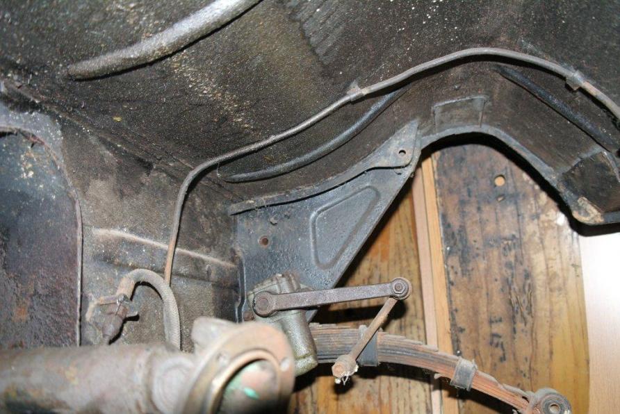

Anyone have a simple picture of how the rear end connects to quarter elliptic springs on a BE and how radius arms connect. BE i'm looking at has rear end out of the car. The Right Rear Spring is installed and the other is out of the car due to a bulkhead repair. Parts never got put back together after all of the metal work was completed.Trying to figure out how rear end attaches to the BE. Looking at my Bible i.e. Moss Catalog, it doesn't show clearly how things bolt back together. Is it simply what appear to be large bolts on the top ends of the differential that go through the bushings on the quarter elliptic springs. I'm trying to figure out a transport issue and whether or not I need to fabricate something to support the rear end for transport on a trailer(i.e. furniture dolly and some 2 x 4's, or do I need to try to find all of the parts and pieces in the P.O.'s garage and try reinstalling differential prior to transport.
Engine, tranny, differential are all out of the car. Front suspension is still installed so transport weight will be light for the top. Biggest question, I think I could load & move with a furniture dolly supporting the rear end. But how to secure the back end of the BE to a trailer with nothing to tie it down with i.e. Rear end and only one quarter elliptic spring installed on the PS? Thoughts gentlemen?
Jim_Gruber
Jim_Gruber
Right Rear Spring and Shock 2.jpgHere's all that is there to secure to. LR Spring not currently installed.

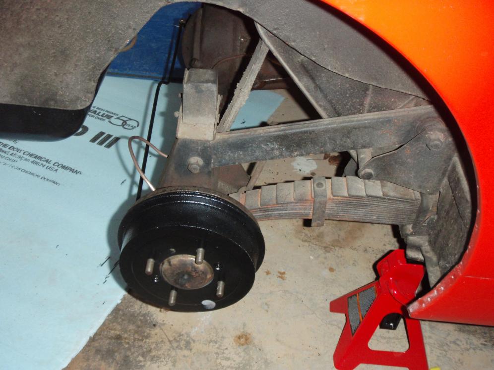

Rut
Jim,
Not a good picture, but I hope it helps.
Rut
Jim_Gruber
Jim_Gruber
Rut, That really helps. So does the Spring then attach to what looks like a bolt that runs parallel to the differential. From the Moss Catalog it's not real clear how things connect and I had no clear how the Radius Arm attached. Now the question is how to transport with only a spring on one side. OK I now see what the radius arm attaches there is a mount on the outer side of the trunk bulkhead that I wasn't seeing on both sides. A very effective tie down point can be made there and rear end of the car could ride on a furniture dolly or something similiar. And it looks like radius arms are still attached the the rear end. I think the light bulb just came on.

Two furniture dollies will make moving it easy. One guy with a good back can even load it on a trailer in the stripped down state your car is in. Just get all the parts shown in the Moss catalog. Especially the peculiar bolts unique to the B/E rear end. To secure the car, remove the dolly and stap the car down through the doors and secure the front suspension

Mine has been transported on a wooden dolly with the car lag bolted through the rear spring hangers in the back and frame horns in the front. Use bigger size wheel on the dolly, otherwise you'll have trouble with them digging in or getting stuck in small divots on whatever surface you are on. I used 2x6's for the two boards that span the width. I attached the wheel to the 2x6's. When on the trailer, I would secure the car with hold-down straps around the radiator uprights, in a "U", each metal end hooked to the trailer. At the rear, I bolted sturdy short chains to the brackets where the shocks are mounted, then attached hold down straps to the chains. If the heavy brackets where the radius arm attaches are still attached, you could secure there too. The thing never moved an inch.

Jim, if the spring perch on the other side is done it would only take minutes and some hardware sourced bolts to make it a roller. I think that is what I would try to do to transport it. Sounds like good project!

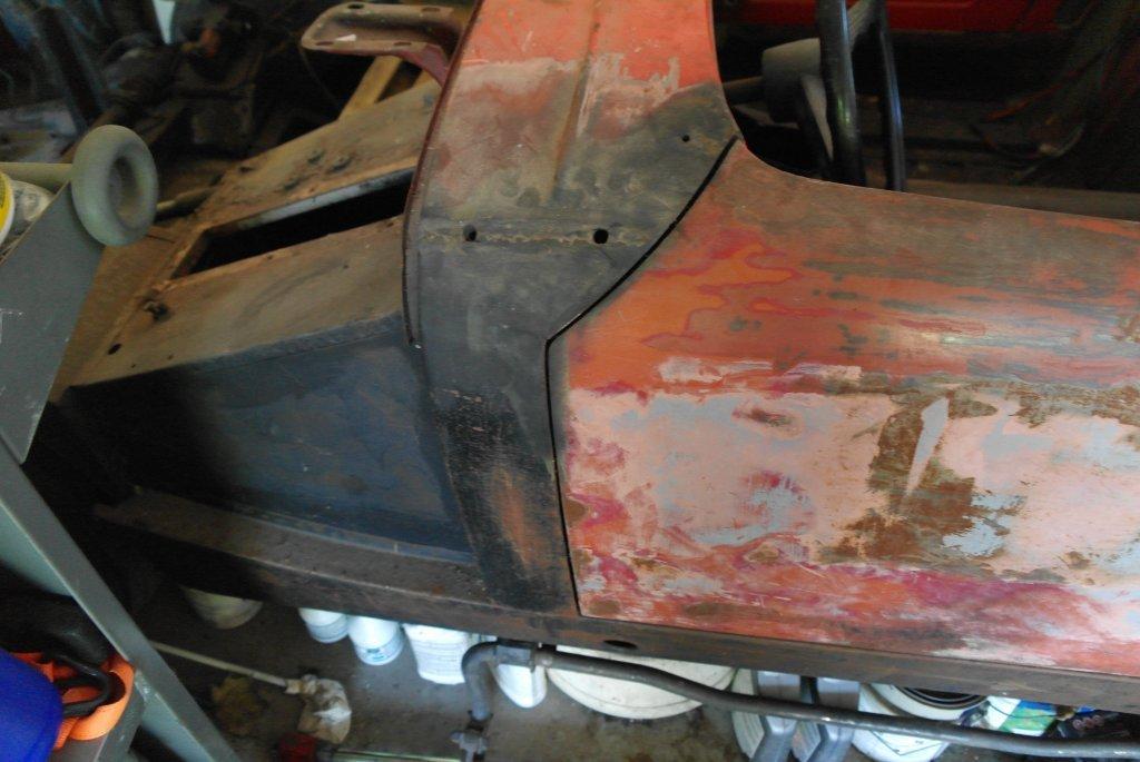

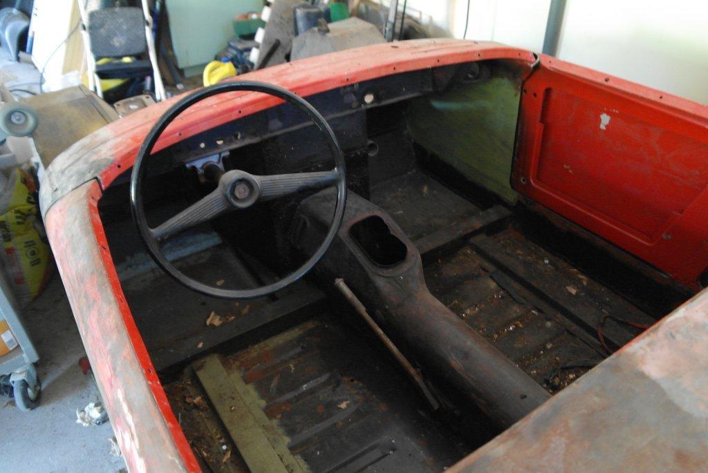

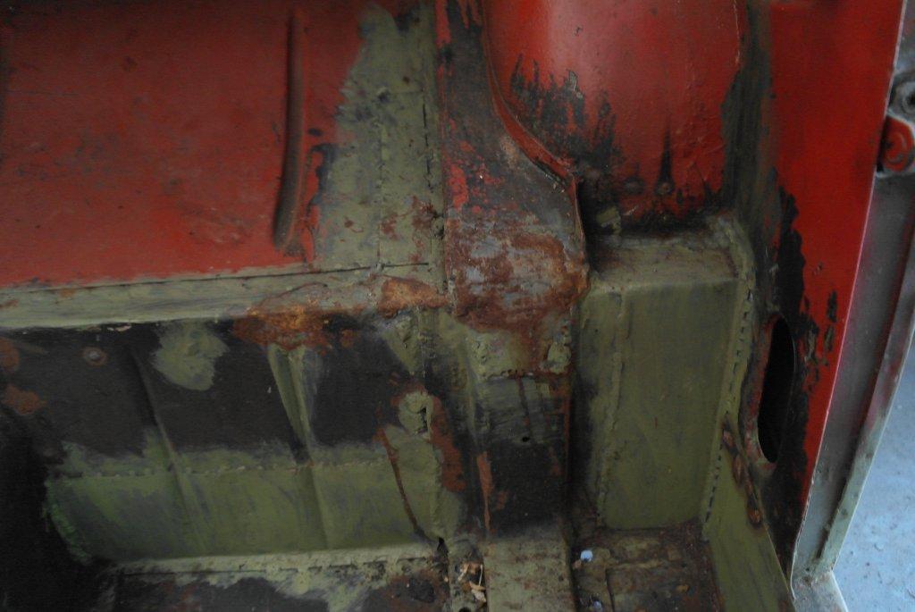

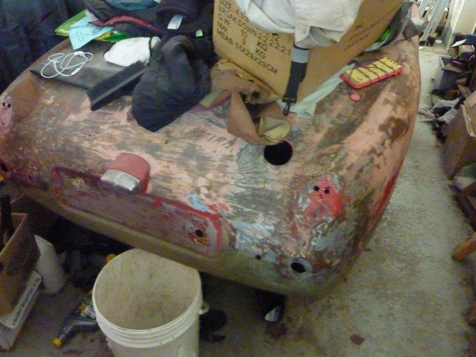

Nice Door gaps, repaired bulkhead, all bodywork repaired in lead and then sprayed with green aircraft preservation primer.Cowl and New A Post Rocker.jpgHardtop - 3.jpgRear of Tub.jpgDrivers Side - Interior Bulkhead Replacement.jpg

Jim, think you have found a treasure. Looks like a pretty straight car.
Kurt.
Jim_Gruber
Jim_Gruber
Kurt,
Door gaps are all good, well at least on the DS and I've been assured they are the same on the PS. Access to the PS is blocked by a wall in the garage. All of the important parts are there. Seat Bases are good, cockpit surround is there, new grille purchased 25 years ago, and most important structurally sound. Restoration will be mainly cleaning, grinding and filling, inventoring what is there and figuring out what parts are needed, prime and paint and reassembly. There is an uninstalled interior panel kit, 25 y.o. new top and lots of other stuff that will need to be blasted and POR-15'd on the underside. I can concentrate on reassembly rather than welding in new metal.

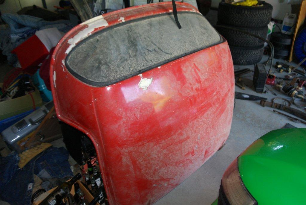

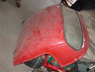

What is the condition of the hard top? Will you be spraying or rolling? If you need some hardtop restoration. Tips let me know. It would be a nice project for your spare time this winter and SHMO would not have to know about the new car.

Hardtop looks to be excellent. Liner is still in there. And from what I can see from multiple pics it looks great. Likely will remain Red. And I already know where to get seals and necessary aattachment hardware if needed. No clue yet on painting. I did Bugsy with a roller and he still looks good 5 years later. It all depends on the budget. There is a guy at the end of our block that is into major muscle car restorations and he paints them all in his driveway. I may need ot get to know him better.

I did my hardtop with the roller ( I can not seem to find my posts on the BCF when I did it in 2008). Interlux Brightside paint. I will have my car painted in the next 4 weeks, using the same paint. I have to have it done by Feb 15 as my uncle is coming over from Holland to help me assemble the car. I will post pictures when I am done. We need to warm up a little (it was 25F) last night.
