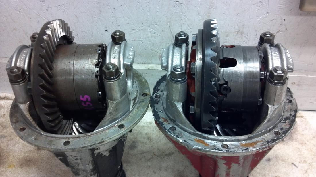

The pictured "limited slip" looks more like a Detroit Locker to me. A true "Salisbury" limited slip has more of an open assembly and one can see the cross pieces for the axle drives. Color is typically a rustoleum primer red. Parts are rather difficult to come by. Detroit Lockers are much more susceptable to throttle induced "lock/un-lock" in the middle of the turn. Preference should be towards the Salisbury which is a clutch-pack type carrier. Modern equivalent is the TranX. The break away torques are set by the shims in the clutch pack itself. Any of the differential carrier types (Open/Stock, welded, Salisbury, TranX, Detroit-Locker, Phantom-Grip and ZF-Cam&Pawl) can be setup with any of the casings whether C or D from the exploded view of the parts catalog. Rings and pinions can be moved from casing to casing if the right bearings are used.

I would go back to Tom and ask him to double check what kind of a diff it really is. The BLMC Competition Department did sell a Salisbury limited slip differential under part number C-BTA1226. I've got one and it looks as I've described. I've got a couple of Detroit Lockers as well and they look more like what is pictured. If it is indeed a Salisbury, and the price is reasonable, I would buy it immediately.

Spridget64SC
The diff on the left is a Detroit Locker. The diff on the right is a BLMC C-BTA1226 Salisbury.
The one on the right
is a clutch pack limited slip. HTH some more. 4.55 Detroit Locker vs 3.90 Salisbury.jpg
