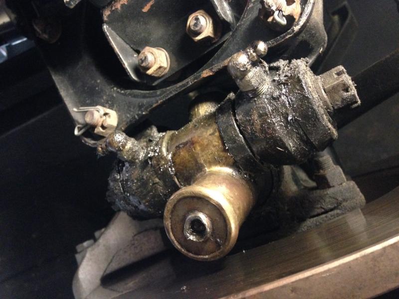

Found that the drivers side, trunnion grease zerk Is missing, the threaded hole in the base of the trunnion is distorted and the brass cover is slightly distorted also. ( impact damage)
Any suggestions on repair options?

Hardly seems worth the effort. Trunnions are consumables, so I would just replace it.
However, you could take it apart and use a drift to more or less push the end cap back into shape, then run a thread repair tool into the threads. 1/4-28 IIRC.
If that won't work, use a Helicoil.

Probably, someone tried to use the trunnion as a jacking point. If the trunnion doesn't appear to worn, I would try to retap the hole (1/4"-28?) or go to an oversize fitting, possibly 1/8" pipe. Also, I was less than impressed with the quality of a repro trunnion purchased for use on a TR6. The fit was looser than the worn original.
Berry
Berry, you nailed it ( pretty close) I found the old zerk in the corner of garage. I surmise the trunnion was damaged when I had a Jacking accident the other day. I think the zerk was knocked off when the car shifted on the stands.
also I was trying to make a mountain out of a mole hill. Simply had to flatten the distorted end of the trunnion with a 3 lb. persuader & retap with a 1/8-27 Pipe thread tap. The old zerk went right back home and seems to work fine.
thanks everyone, for the input
