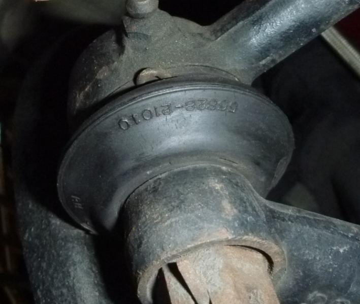

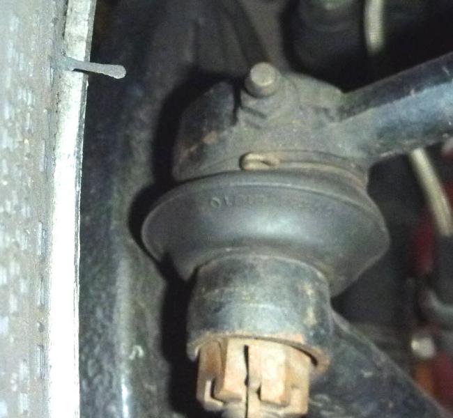

Someone on the email list sourced these years ago. Mine were installed in September, 2006. All four still good. Just took this picture.
TieBoot2.jpg On closer examination, it looks like some micro-cracks are starting to appear. They may only last ten years. :grumpy:
PS - at the time I had Moss boots which cracked immediately before I could even get the car back on the road.
Hopefully newly purchased examples are still just as good.
View attachment 36326 On closer examination, it looks like some micro-cracks are starting to appear. They may only last ten years. :grumpy:
I called a Dealer last year and was told that these were no longer available.
