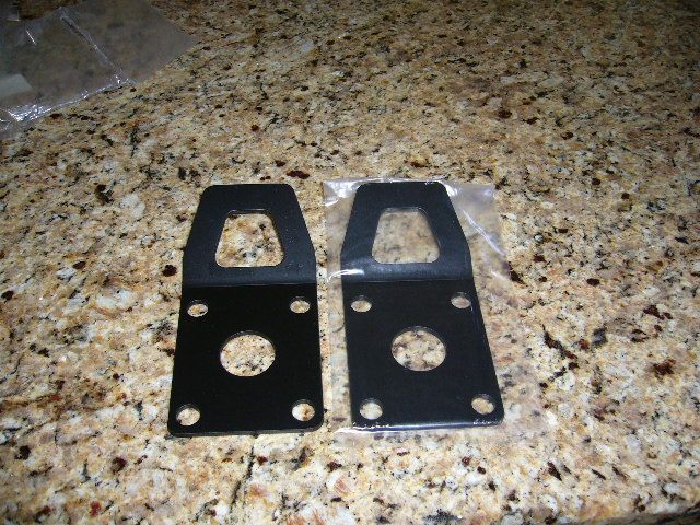

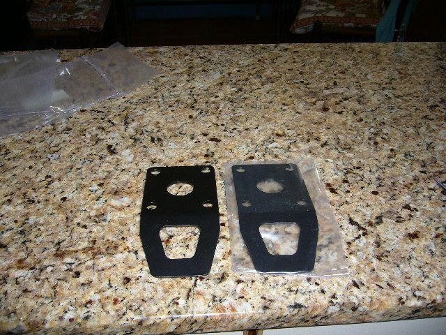

A few sources have the Front Tow Eyes and I'm going for them and also the Rear Shackle mounted Tow Eyes. I am going for the leaf spring mounting plate Tie Downs. I'll see if I can post a photo of it tomorrow.

Here's a couple of photos of the brackets I'm using for rear Tie Down. They bolt to the spring mounting plate.

The brackets that Patrick has for the rear spring U bolts are a pretty good way to go for the back of the car. I have a set of those but do have some reservation about installing them. But it seems that each method we talk about to secure the Healey to a trailer has its drawbacks. At this point I have decided to wrap a soft strap around the rear leaf spring just forward of the U bolts.
