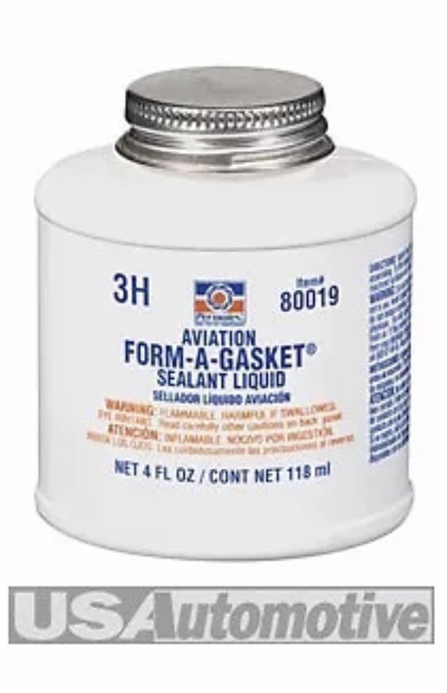

I found this gasket fluid here in the Uk eventually really great stuff.
