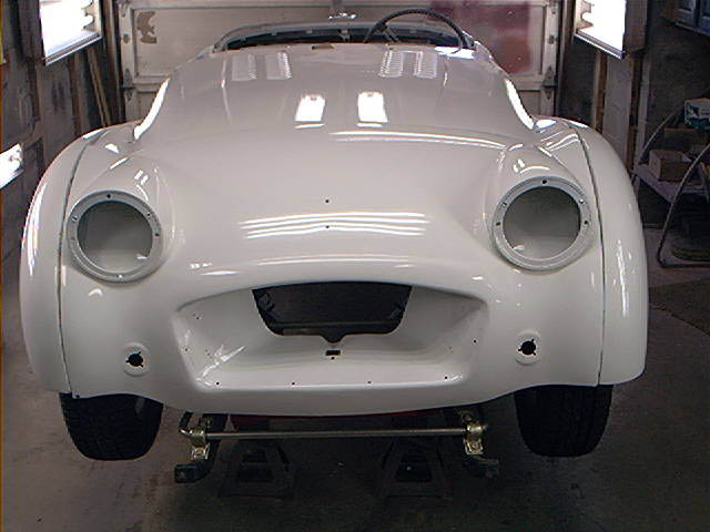

I love the looks of the smallmouth, TR3 that is, but the bass to.
I also like posting this pix of mine,....I know ya seen it,...I dont care...I like seeing it.....ON THE BIG SCREEN....in techni-color.
Its been sittin like this since the OJ trial.
