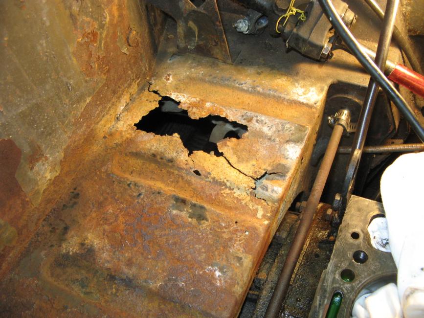

Here (if I can upload it) is a picture of the piston tops. I'll try to upload that picture and my cluttered garage - what a garage should look like. hole in firewall1.jpgII made a mistake & got the hole in the firewall!
