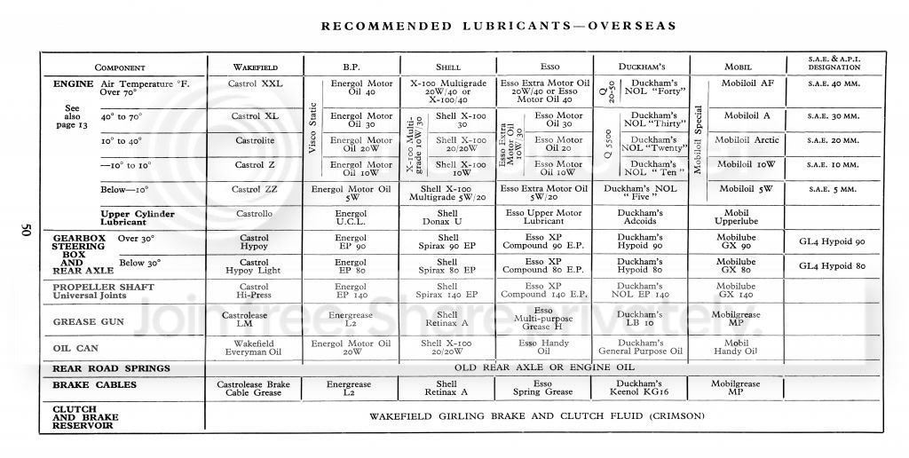

If you ask Ken, he'll also tell you why the factory switched from recommending motor oil to recommending gear oil.
P50LubricantsOverseascook.jpg~original
But obviously those factory engineers didn't know anything about cars :devilgrin:
