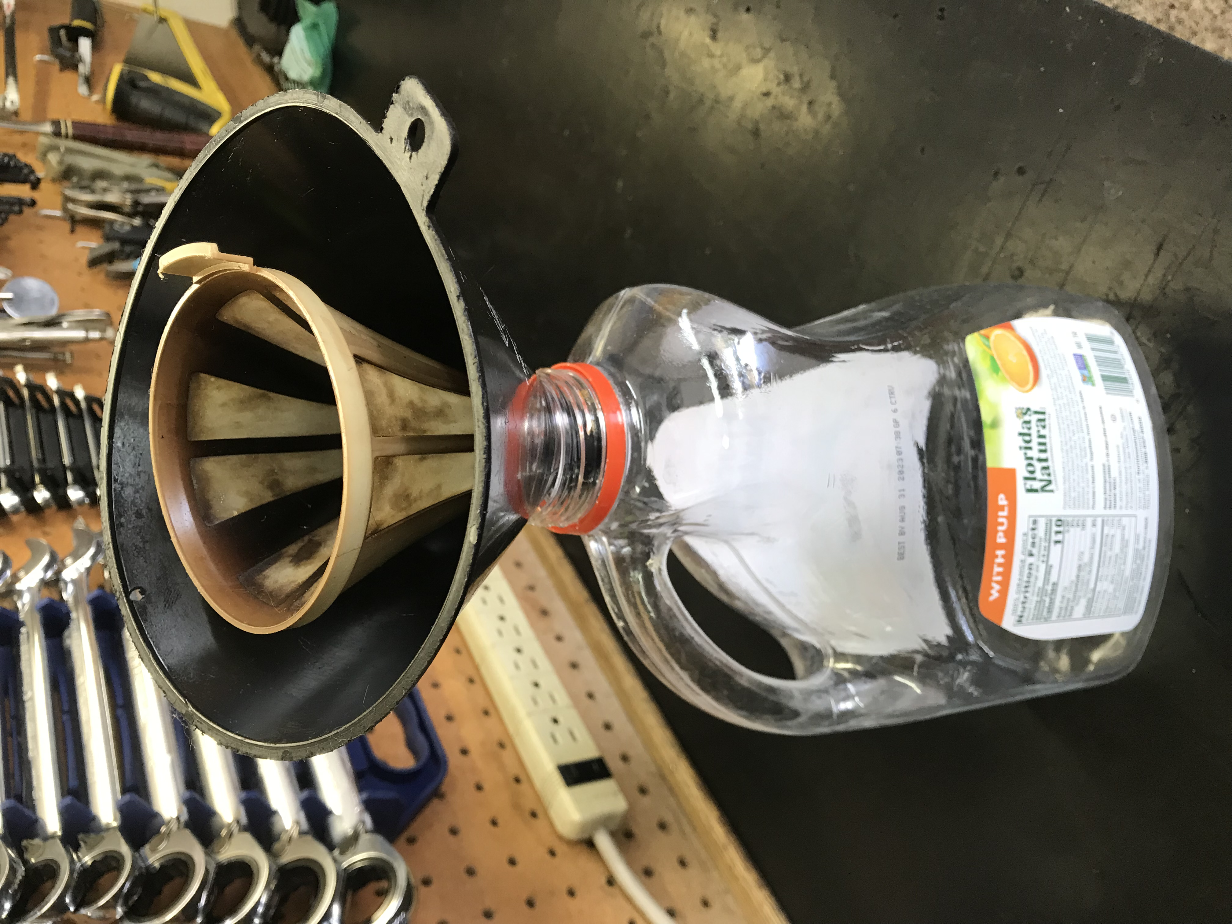

The way I flushed the tranny/OD was new Napa 30w non detergent (it's valvoline brand) oil. Drive about an hour and drain it. I used a nylon coffee filter basket as a strainer (10-20 microns I believe) for the oil and put it back in the tranny/OD. Did that multiple times till I didn't see any more Debis. Then new oil...30w non detergent.

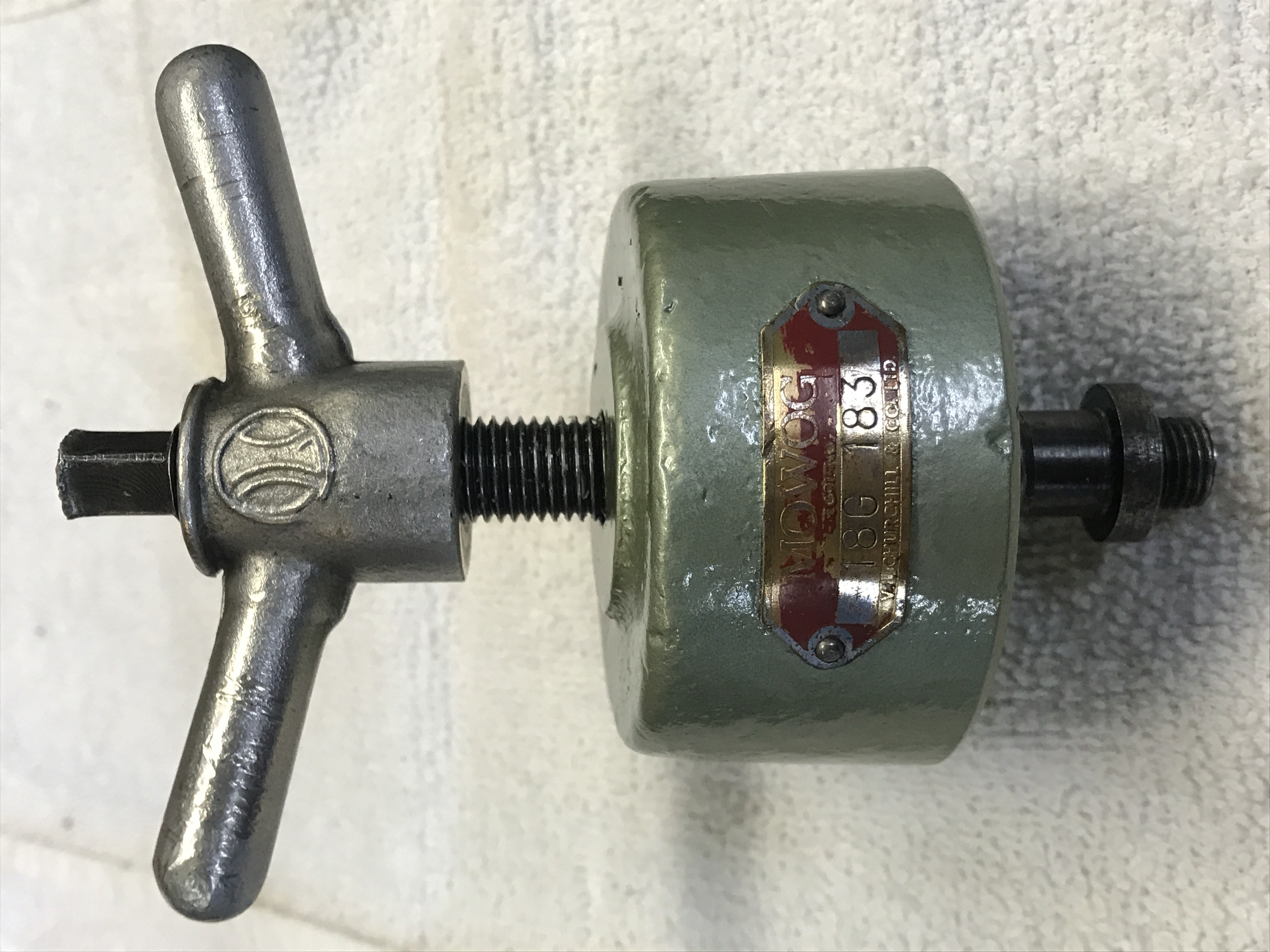

If I remember correctly (it's been a while) I believe when you remove the solenoid bracket (moss 37) and using a flashlight you can see if the oil pump plunger moves.
If you determine the OD pump is defective it can be removed. By removing the OD drain plug and using the correct tool (photo attached) or making one somewhat like it, you can pull the pump assembly straight down. Look for damage, fix or replace. No need to remove the transmission! (shout out to my Healey friend who turned me on to this and helped me with this);)
For removal, you'll need to remove the overdrive ball valve (moss 101) plunger (moss 102) spring (moss103) copper washer (moss104) and screw plug (moss 105) first.
The ball valve and plunger maybe worn and not making a seal. Some suggest replacement or next step possibly lapping where the ball valve contacts.
