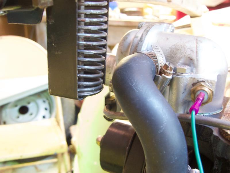

When I look at pic #3 in this post, it looks like your apron bow mounting tabs have been bent rearward...possibly accounting for the missing clearance. There is room to bend the mounts forward, or at least "straight".
I agree with John, I'd try and straighten the mounts a little bit and this will bring the cross bar ahead a little.

There was a lot of body work done to straighten things and fit the pieces together ( about 20 years ago) as the car had been banged up enough to bend the frame and the Right suspension turret. So the bent looking tabs may be that way on purpose and I won't know until I put on the bonnet and apron as John suggested. (By measurement the crosspiece is perpendicular to whatever it is supposed to be (i.e. it is parallel to the bullhead!))
This weekend may tell all.
Thank you all again , and I too had worried about that battery! I bought a nice black one. I no longer can be picky but would like any future owner to have a good foundation: Just want to get it running and on the road for our pleasure It has been long journey.
thank you all
Michael

From the pics I have seen there is quite a variation in the fore and aft position of the motor, at least as judged from the closeness to the crosspiece. Some are at least 1/2 inch clear, some almost touching. I don't know if this relates to the transmission used.
John. I don't know if I answered your query about the spring (and pin) being tilted. It is at right angles to the crosspiece which is indeed slightly tilted ( top forward) to match the curvature of the wheel arch The bonnet fits exactly to the crosspiece. I could probably bend the spring unit to be a bit more vertical.
So I shall carry on as is, and if it still looks dangerously close with the engine running (this weekend?) I shall remove the 4 rear mounting bolts and see if I can slide the engine just a teeny bit backwards and then grind out the holes.
I hope, perhaps foolishly, that I won't have many more problems to solve ( and that the engine actually starts after 25 years or so).

1. I noticed that the bonnet spring bracket was slightly tilted at the base, so that the spring was backward and the pin forward. I reversed this ( losing a cup washer into space in the process) and now both spring and pin are vertical. Did not see this possibilty earlier.
2. I unbolted the rear mount crosspiece form the frame, jacked up the gearbox, and found everything had slid rearward about 1/4 inch, maybe more. It looked tricky to extract the piece so I ground away with it in place until I could get a clear drop into the bolt holes. Then a longer bolt, and a tough flat washer to spread the load and be sure the lock washer had something to bite into, and a good yank on the wrench.
Does any one have experienced of removing that crosspiece without removing the drivetrain? It looks as though it would foul up on the overdrive. I would really like to replace it with a new one and better drilled holes!
any way, I am much happier with both changes. One day soon i shall venture to start the engine after its long dormancy.
