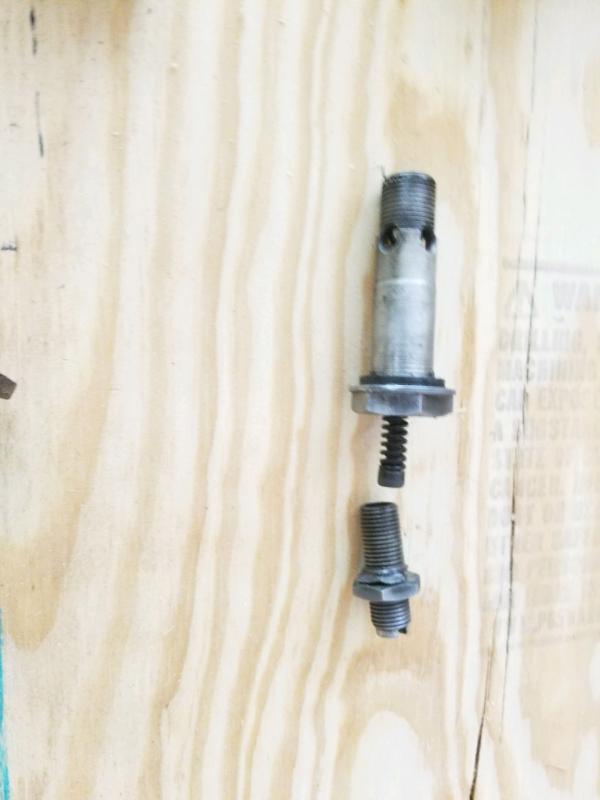

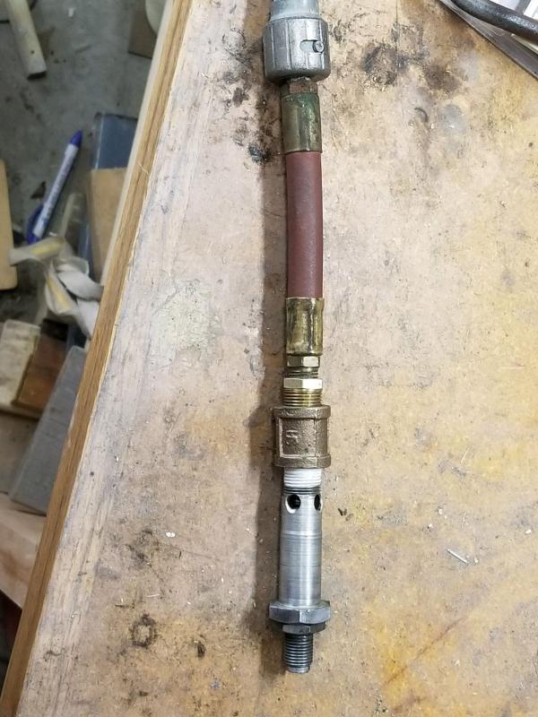

I took the PRV out and took a look at the ball and seat. Both looked OK so I set up an air tester so I could see what was happening. Both the PRV from the car and my spare leaked despite having corrosion free balls and seats free of damage.
I had some valve grinding paste and made a wooden grinding tool and attempted to clean up the seat. That did not seem to make much difference I decided to try lengthening the spring as the adjuster was bottomed out. With a little experimenting I got the right amount of spacing above the spring to hold air at 70lb but blow off at 75.
Running the engine I have a higher pressure now. 80lb when cold but I think my gauge may be reading high by about 5lb. Have not driven yet but will report the results.
David

Nice Job David, I wondered how someone could test, repair, and adjust those things. I always felt unsettled around them because I figured that one of the P.O’s at some point fiddled around with it. I plan on starting my motor this week and that is good information to have on hand.

I had the adjustment bottomed out and it was blowing off at 55 to 60lb It also had a leak. Thinking about it later I feel that a small disc of 220 or finer wet and dry on the end of my pointy stick might have done a better job of cleaning up the seat.
Make sure to clean all the abrasive out when you are finished.
I added a 4mm socket head screw to increase the amount of compression I could get on the ball. The screw slid inside the spring and the head fit in the adjuster. With this setup I could get the pressure up over 80lb and adjusted it down and locked the adjuster
