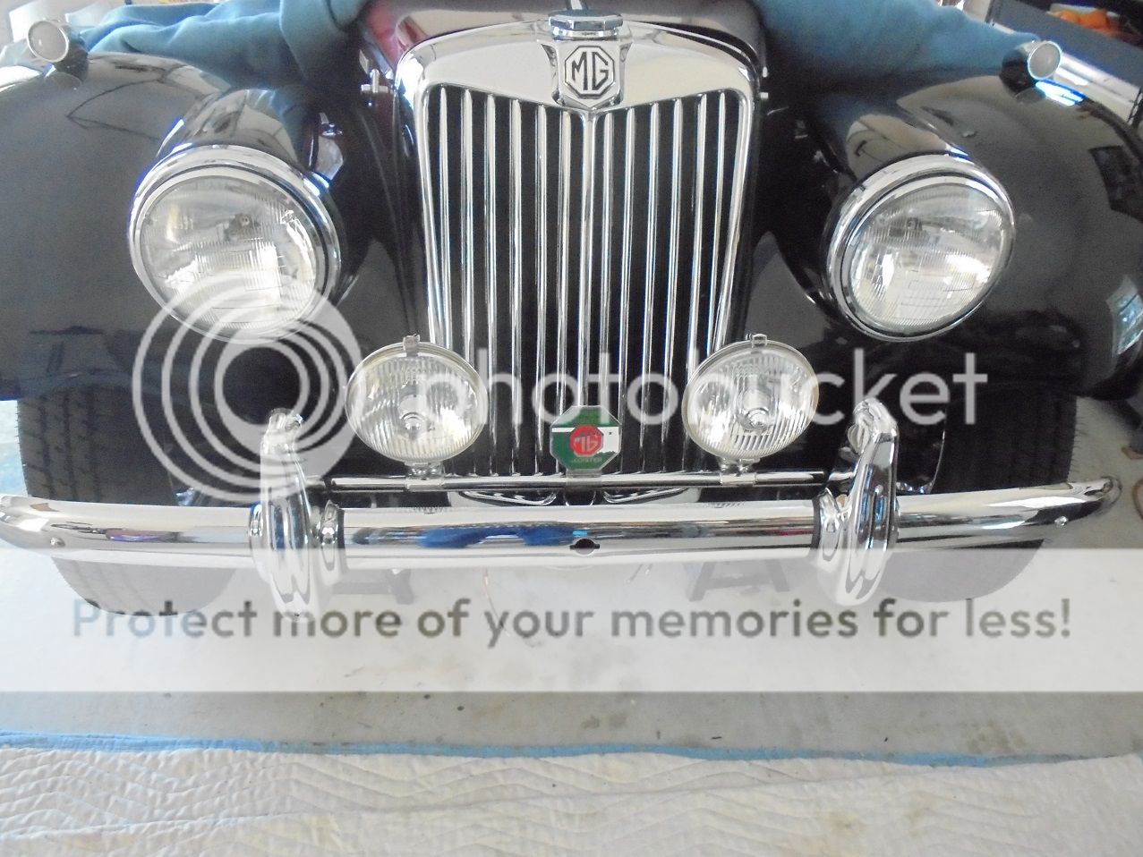

Just put these Lucas fog lights on the TF. They are very bright and look good. Installed with a relay to take the load off the A switch. :encouragement: PJ

Thanks guys! Aside from aiding night time driving in foggy weather, they kinda give the car a more complete look up front. They are super bright, I just have to make sure they are adjusted down at a proper angle, too high and they would blind an on coming car. PJ

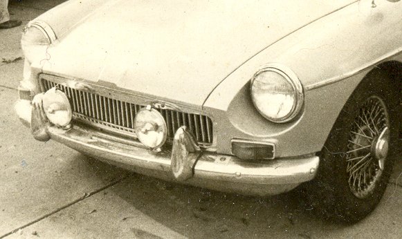

I thought ya should have one fog and one straight beam. My first MGB, I put one of each on it, pencil beam to port, fog to starboard. On a T.P.D.T. switch. In the open O.D. hole in the left side of the facia. First position was the fog light, second was both. Powered off of the running light side of the headlamp switch. Worked a treat!
