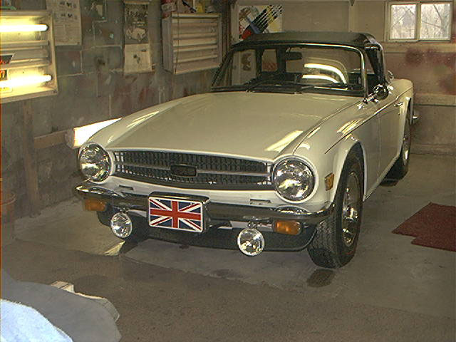

The "approved" fog lites were Lucas square 8's. Anything you like is ok. Mine are aftermarket.
