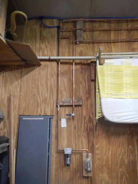

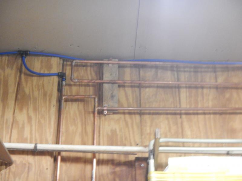

Having bought a real compressor (60 Gallon Ingersoll Rand 5 HP) I followed John's suggestion on piping. About 50 feet of copper tune hung up by the ceiling with a slight slope towards the outlet. The idea being the air has a chance to cool and some of the moisture will condense in the tube. At the outlet end there is a "T". One leg goes down to a drain valve and the other leg goes up to feed the shop.
Having done some sand blasting I got a bit of water out of the drain valve.

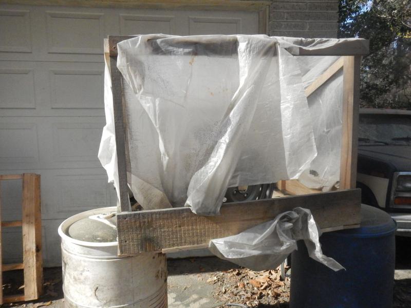

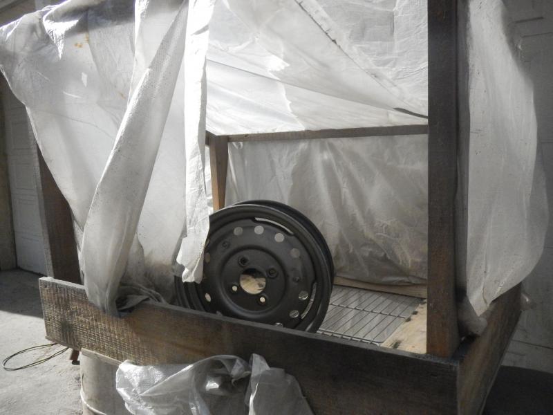

Needing to Sand blast some smaller parts (Wheels and seat back) and did not have a blasting cabinet so I made a temporary one. Worked fairly well at no cost.

In the days before PVC pipe copper was all we had in England so I learned early how to do copper joints. Ours were a bit easier as they had the solder in the fitting. Clean, Flux and heat was all it took. Wiping lead pipe joints took real skill one that I never mastered.
The copper in the photo is the latest addition. The blue line was added a few months ago as an easy way to get air to several locations and connect the new setup to the rest of the shop. The blue line is a Northern Tool 1/2' Poly tube kit which is great to work with.
