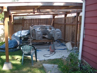

Hi Kevin I do a lot of blasting with 70 grit sand and I find that 125psi at about, I think, 10 cmf the paint or rust or whatever comes off the metal and actually polishes the metal and prevents the return of oxidation. Perhaps you need to turn up your compressor a little. You will not hurt a wheel.
