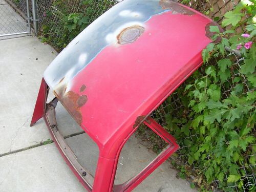

I've always liked the look of a TR6 with the factory hardtop, but I never had one. A couple months ago I picked up a rough factory hardtop (see attached picture). Stripped, filled, primed and painted it. Bought new rubber and installed the glass, mounted it and drove about 100 miles yesterday. The car is quiter, visibility is great, and even though my six is a daily driver, it got more thumbs-up and stares than usual yesterday. With a shiney top it doesn't look like 'just another two-seater'

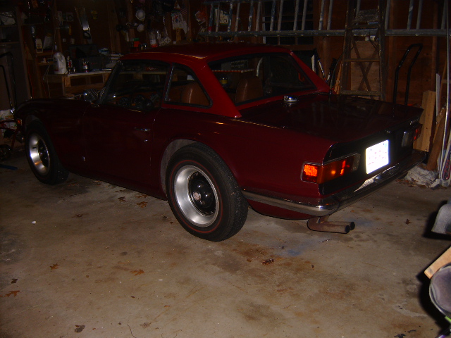

I'm going to try to attach a couple pix I just took.
Again, this is a driver, not a looker. About a year and a half ago I bought 2 1972 TR6s, put the best into this car and sold the rest. I drive it year round here in Massachusetts and do my 50 mile round trip commute to work almost every day.
