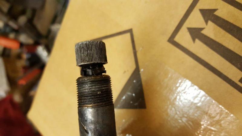

Do you know of a lucas parts source? There's a rubber cup on the wheel. See attached. I'm guessing that keeps water out.

We pulled the wiper motor and gearbox apart. Great shape which was a surprise based on the greasy dirty mess the outside was. Cleaned, painted, lubed and put it back to together. Bench tested and the motor wouldn't budge. Part of the problem with my BJ7 transition car is that it uses some newer and some older parts. The wiper is the old style. I re read the Bentley manual over and over. Couldn't see why it would be pulling 10.5amps. Range should be in the 3amp range. Then I notice that it has adjustable bushings. What the heck is that? I now know that they are a ball of sorts that self align the shaft and must be clean and lubed. Problem solved.
It was lot of work for an ornamental rig (Don't plan to use wipers) that's out of sight!
