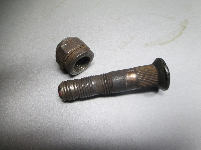

BJ8Healeys
Here is an example of an original nut, with one of the studs that was damaged by running with the nuts loose. Note that the nut appears to have two washers on top of it, but that is actually the locking feature. It is two thin cuts partially around the circumference of the nut. These deform when the nut is torqued to better grip the stud.
