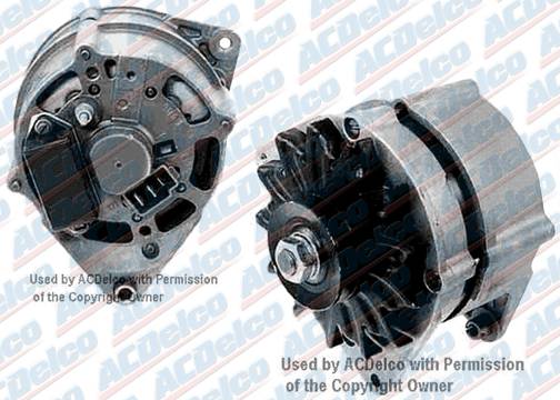

Lots of folks have swapped in Delco alternators, mostly because they are readily available and cheap (in the USA). Generally it's not too hard, but does take some mechanical ingenuity and some electrical modifications.
If you are looking for pure "plug and play", about the closest I'm aware of is the Bosch alternator from a 1978 Ford Fiesta with air conditioning. (Be sure you ask for the Bosch style, as most Fiestas got a Motorcraft unit that is different.) Delco also makes an equivalent for this alternator, but I don't know how to get it other than asking by application (78 Fiesta with A/C). My Friendly Local Auto Parts Store (aka FLAPS) took two days to get the Bosch, and the price was about $80 (including core charge). But that was a few years ago, it may have gone up and/or be harder to find today.
