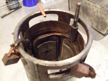

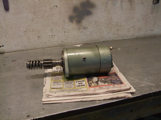

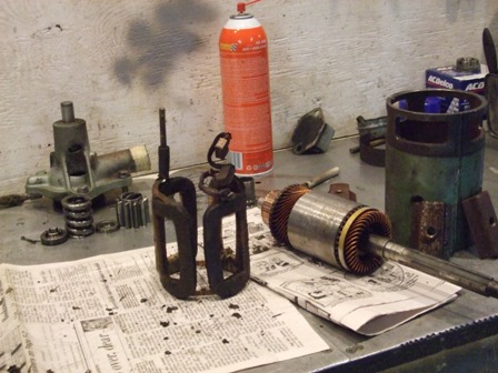

Hi Chuck, The quick answer is all the above. After making sure that you do have tight and clean electrical connections everywhere, I would attack the generator first but I would say don't just do brushes. At the minimum clean up the commutator also. I have some pictures here of my starter which i did over and it is much like the generator. I ditched my generator (running alternator now) because at some time in its life it had gotten so hot that is started to melt the solder out of the commutator. If your generator is like my starter was you can disassemble it easily and clean everything. I was very concerned about the amount of grease and grime that was all thru my windings. I took the windings out and washed them (very carefully) in a water based grease remover then dried them very well in the hot sun for a day or so. Then I painted them with clear coat paint. An old timer told me to paint them with enamel. i said I didn't have enamel but I had urethane clear coat, he said ' that'll work'. Or of coarse you can take it to a pro starter, generator, alt shop. If it is not the generator then I would move on to the regulator. Actually there is a test to determine the regulator or generator issue in the shop manual but I don't have it at the top of my head. So also you could just clean the contacts in the regulator very lightly with something about the grit of 320 sand paper. that certainly might fix everything. But again the shop manual has a very detailed explaination of how to adjust the regulator. I have followed it before in years past to up the charging rate of my generator. You just must follow the directions exactly. Good Luck. Dave.
