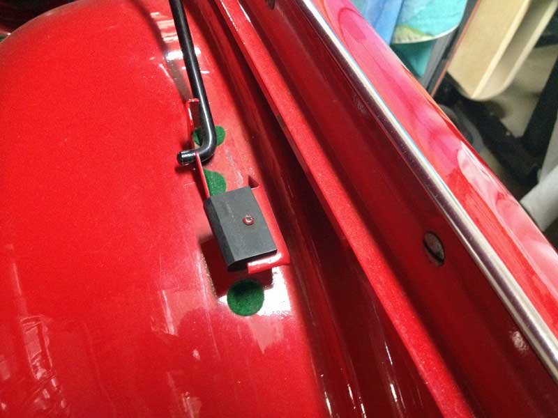

Here are the felt pads I put on. I think the theory of the buffer is that as the bonnet closes, the wheel well pushes it up into the buffer. But that doesn't seem to happen in practice. I'm also missing a bit of metal on the bracket that helps align the rod, but I don't think that would affect the interaction with the buffer. Note that even when everything is there properly, the rod drags across the wheel well and will scuff the paint.

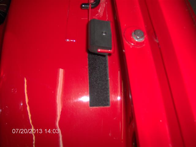

I don't have a picture handy, but I came up with an easy fix for that which has worked for several years. Cut about a 3/8" piece of fuel line and slide it over the end of the rod - not too far to goof up the latch operation. The fuel line acts as a nice rubber bumper when it slides over the wheel well. Works nice!

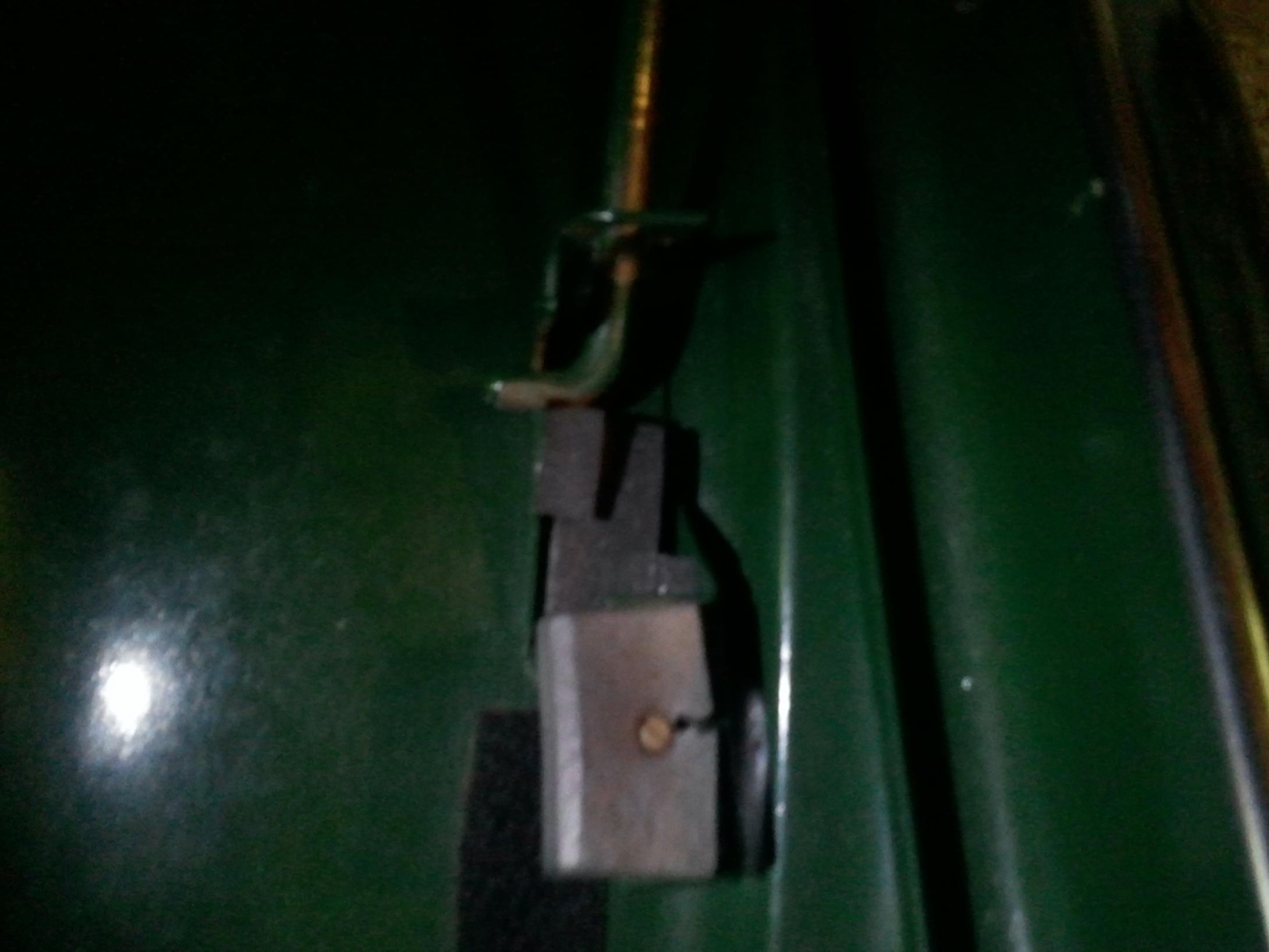

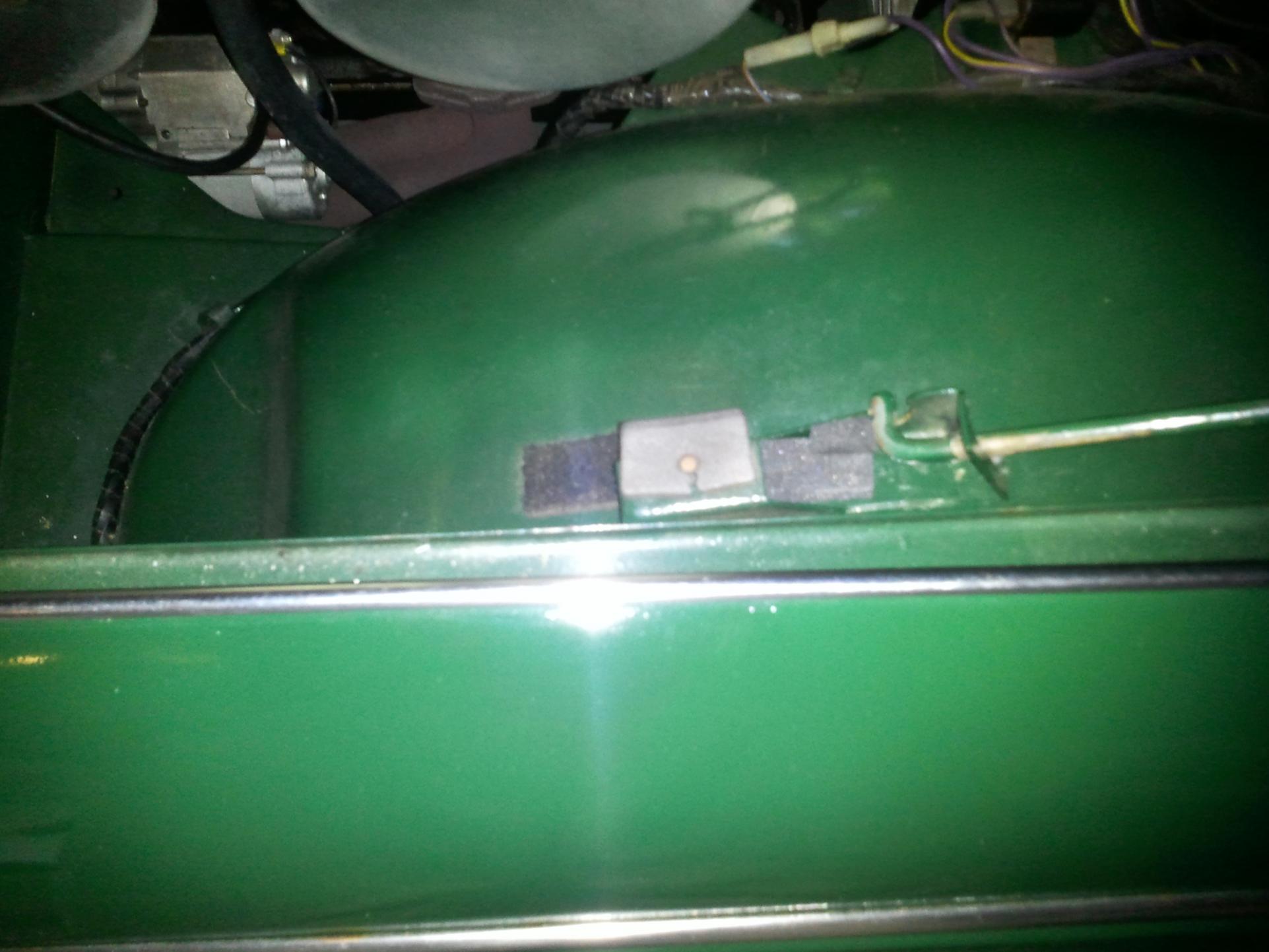

Here are photos
I also hand snugged the nut holding the prop rod to the bonnet. It was extremely loose and was rattling there as well
