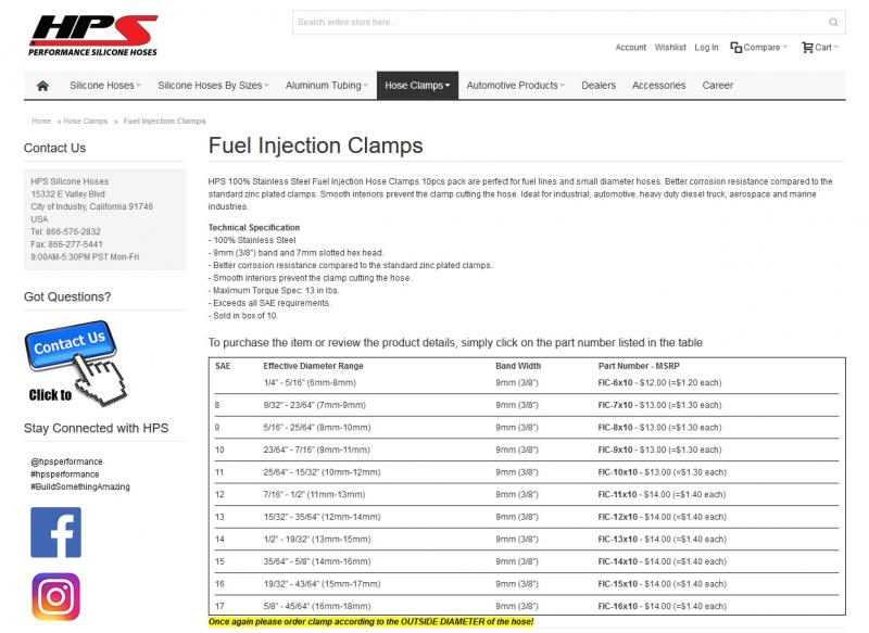

In an unrelated thread we were discussing sourcing high-quality stainless hose clamps of the embossed-screw and fuel-injection types. An Australian source was given for Norma clamps, which are available in the US from JEGS, Amazon and Ebay.
The JEGS SS embossed screw clamps in the larger sizes are mostly Norma and some Murray.
However their smaller fuel injection clamps are zinc plated. My bad.
Stainless FI clamps seem to be harder to find.
These HPS all-stainless fuel injection clamps look to be a high-quality product - available on Amazon or direct from HPS:
