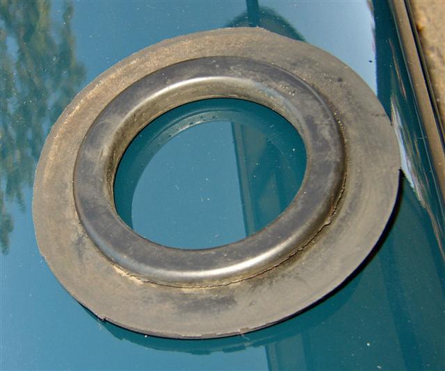

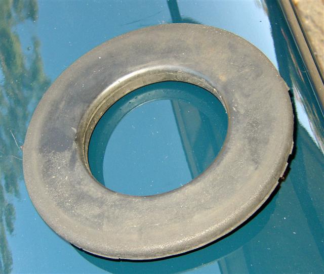

TR6oldtimer
Dale, looks pretty good. The original was a grommet. Attached are pictures of the original out of my '73.

Thanks Ray!
Why on earth would that moron DPO Pedro have
removed the grommet and not put it back?
Mine is not a grommet but it IS pretty snug tight
and will protect the car paint.
thanks for the photo.
