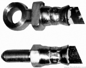

can you post photo of your new hoses? Also, very good idea to change the rear hose at the same time.

Close up of both ends.
