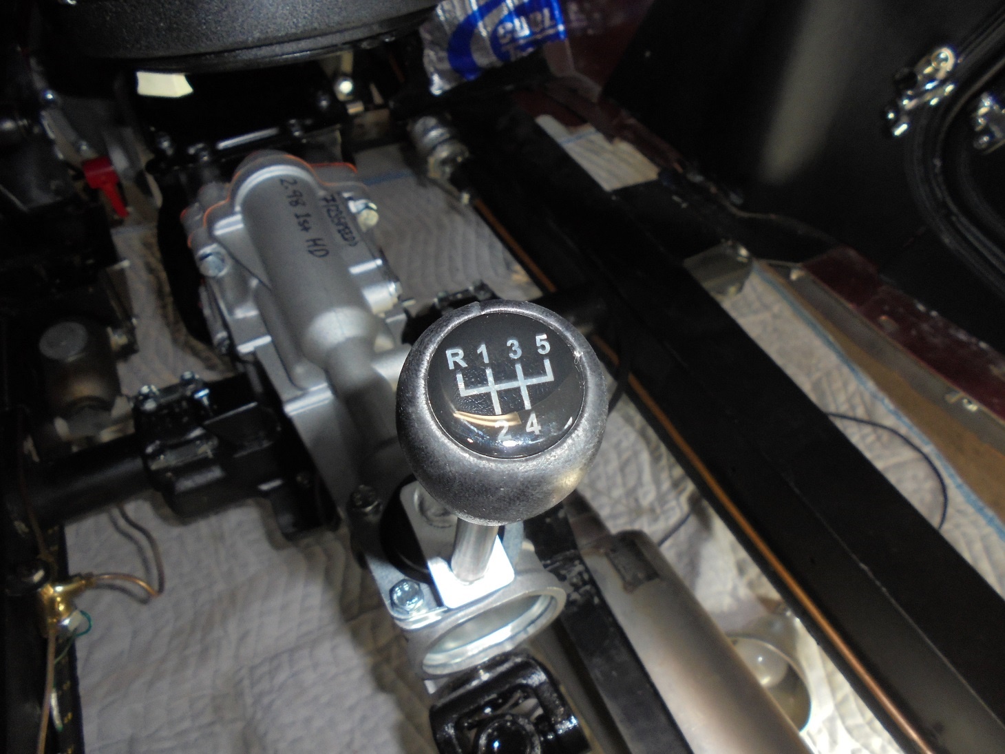

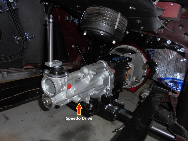

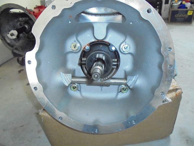

I bought mine directly from High Gear in the UK. I saved quite a bit from the Moss price. It's a Ford T-9-5 speed transmission. I didn't want to move my engine forward so I opted for High Gears cross bar mod and the engine stays where it was originally. It comes with its own driveshaft ready to bolt in and a T-9 clutch disk, I also opted for the higher 2.98 first gear and not the original lower first gear. A few mods to the trans cover, but not anything too complicated. A few pix. PJ

Louis, High Gear has an option where the engine doesn't have to be moved forward, I opted for that setup and it saved me from a lot of extra work as moving the engine forward in a TF is a pain since to do it properly, all the sheet metal forward of the firewall has to be removed. Big PITA! PJ
