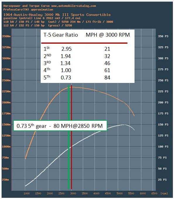

WHT
Michael makes a great point.
I spent several days looking at speed and RPM vs gearing with respect to the Healey's power band (given our tire diameter and differential ratio).
These engines were not designed to be run at lower RPM like modern engines; and doing so will increase engine wear.
Regards, Bill

Bill is correct and lugging the engine can lead to predetonation (pinging), increased load upon the engine's lower end and really lousy passing acceleration.
