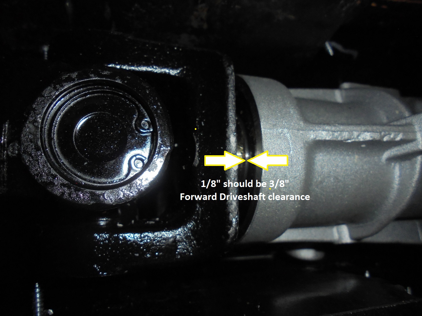

Took the car out and heard a slight clicking when hitting a bump in the road and according to peter at high gear, the drive shaft is a tad too long! He said it's not that uncommon, especially on TCs, but sometimes on other models also. Supposed to be 3/8th inch of the shiny forward slip joint showing, on this one there's about .050! The shaft is approx. 1/2 inch too long, what else is new! :rolleyes2: They will send another shaft when I give him the measurements I have. I might get to drive this car before next winter gets here! :wall:

Three weeks to get another one made and that doesn't include shipping time. So, I've contacted "Drive Shafts Inc." in Tulsa, they will do the job, allowing 4 days to complete and charge $100.00! Hand deliver and pick up. Solves my problem! (y) PJ

Transmission yoke clearance pic. Not enough clearance. PJ

Got my driveshaft back in one day, cut and balanced! Hard to believe. :rolleyes2: If it's nice tomorrow I'll take it for a ride. (y)
