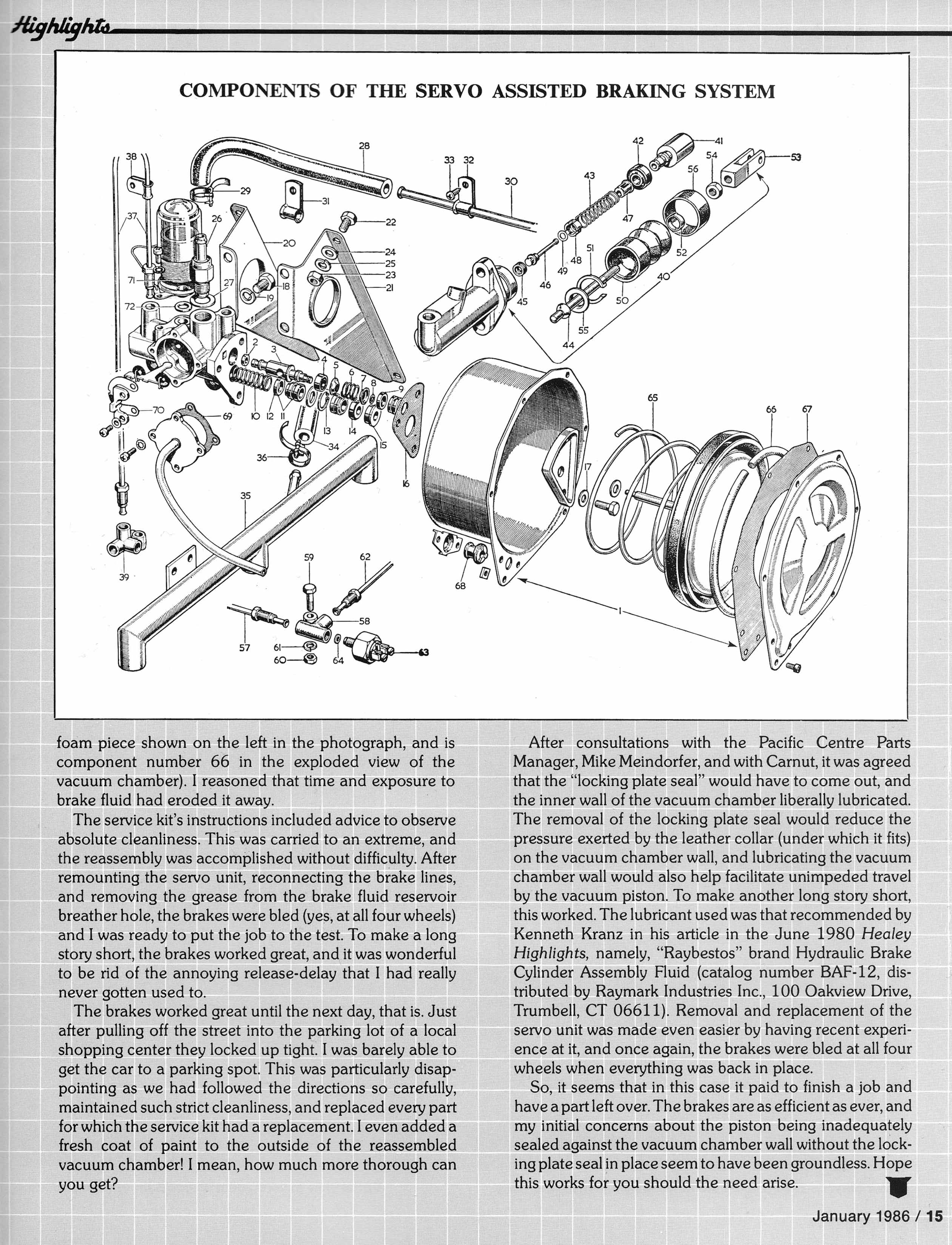

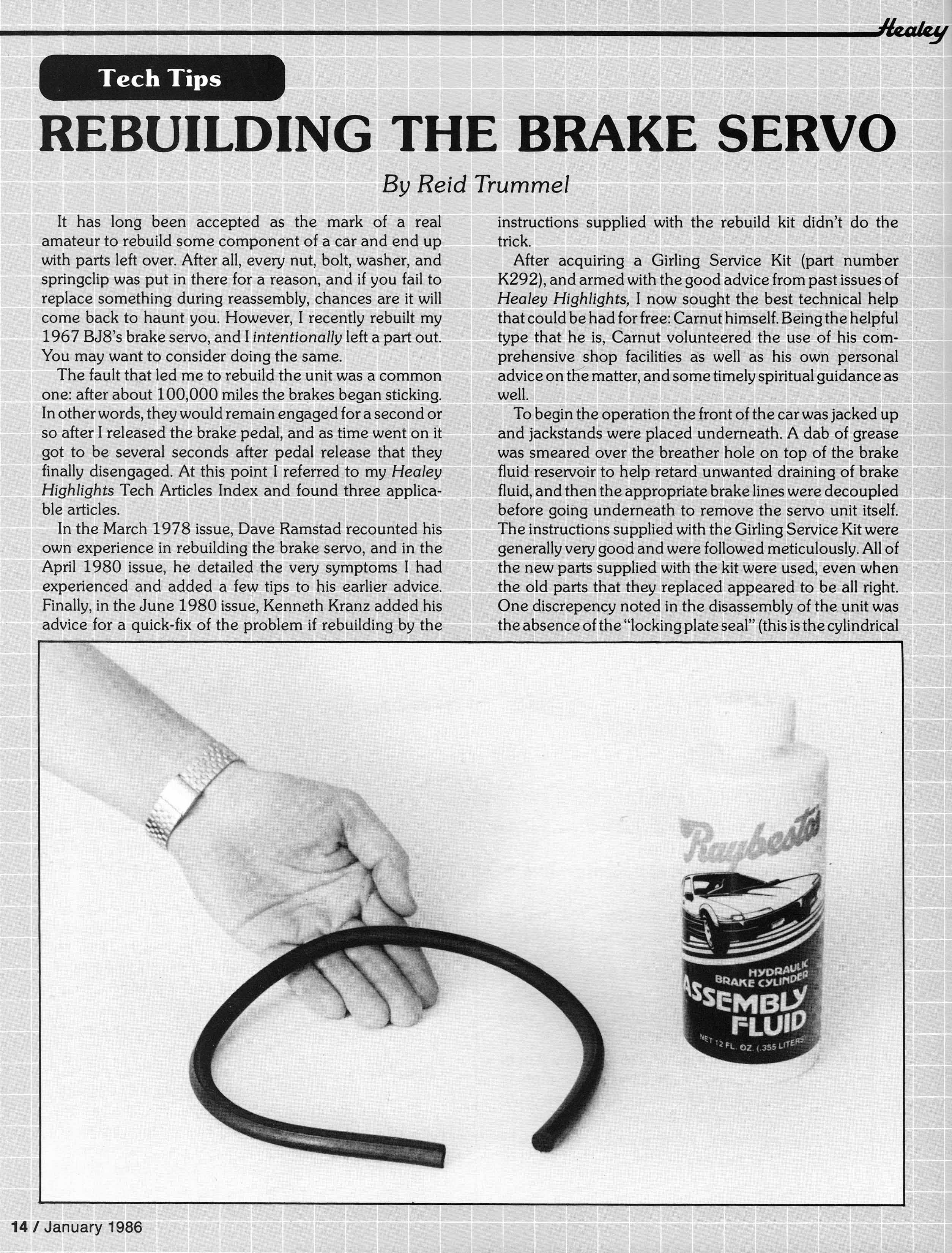

I'm slightly disappointed that the definitive treatise on the subject hasn't been referenced in this thread. I speak of course of my own article in a magazine I produced at the time, namely pages 14-15 of the January 1986 issue of Healey Highlights, a scant 35 years ago. Seriously, I'll be surprised if it is of any use at all to you, but it was fun to go dig it out and scan it. By the way, "Carnut" referred to in the article is Bruce Erfer, as a few old-timers here may recall. Good luck.

I must be an 'old-timer;' I bought a set of wheels for my BJ8 from Bruce Erfer when BWW was his garage, and spoke to Mike Meindorfer on the phone a few times.
I remember being told by someone that the 'locking plate seal' should be trimmed to length--by a SWAG, apparently--because, as supplied it was too long and would cause the lockup described. I did, and have never suffered lockup. The later servos were a bit different, as the seal went behind the leather seal (is part# 35 a carb balance tube?). Later servos also used a dry lubricant in the vacuum canister.
