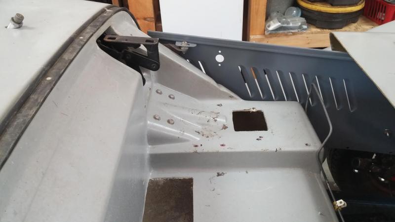

Try sending your pictures to your email address, then copy/download them to your computer and post from there. I just did that with this picture:

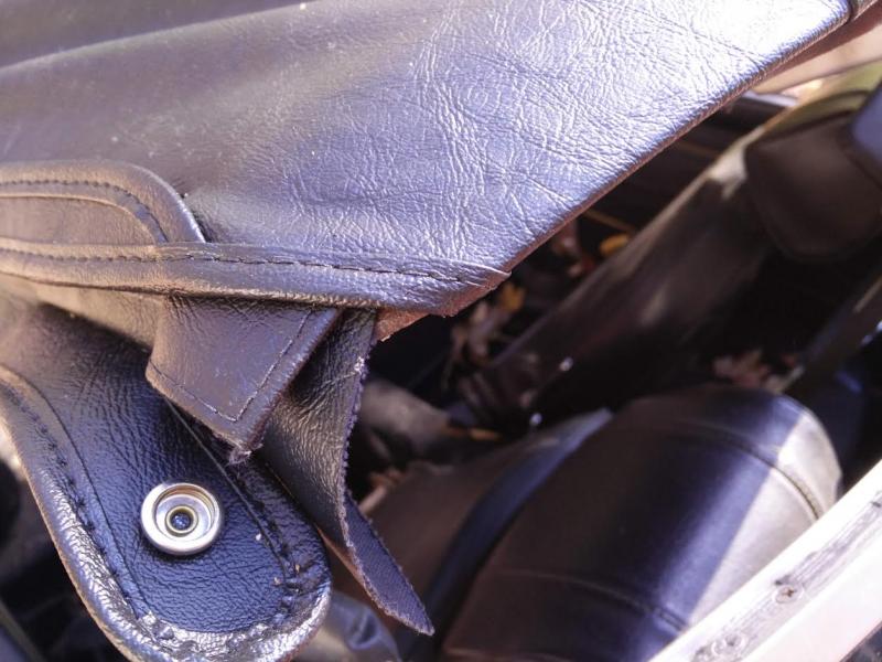

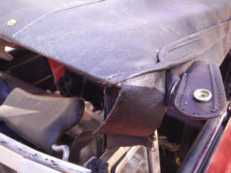

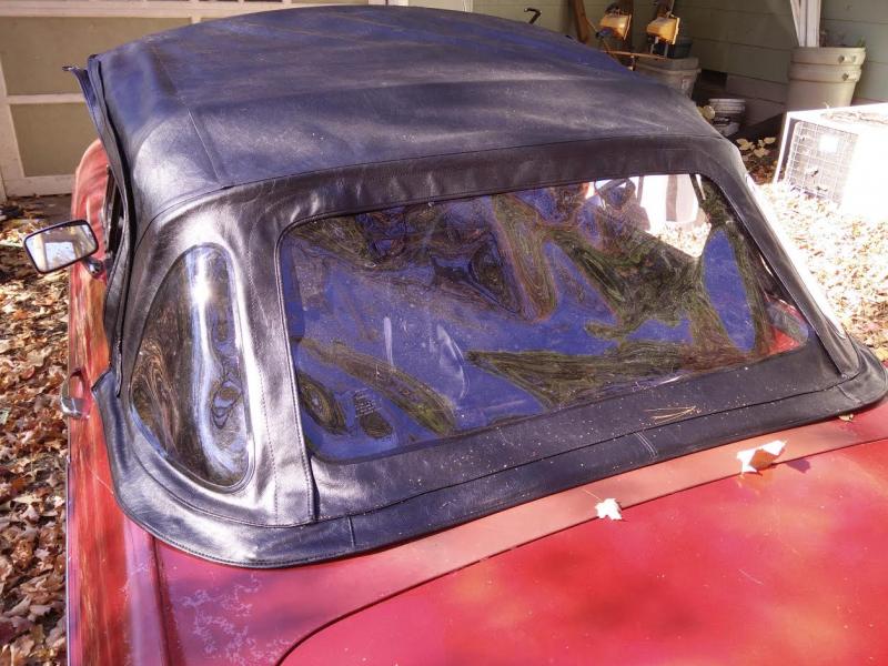

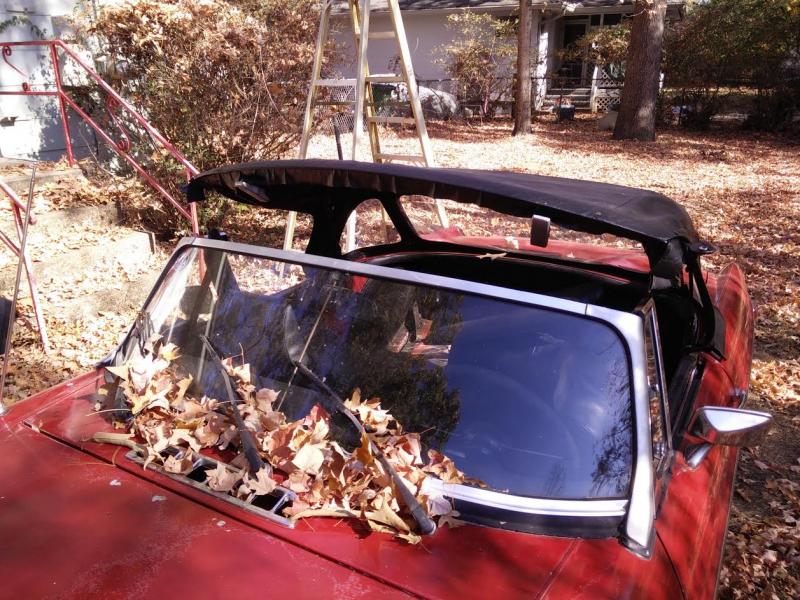

Ok, got some pics. Please keep in mind that nothing has been permanently altered. No cuts in the top, haven't rivited the metal bar to the header rail. The top's in position just to show how tight or loose things may be. Also, the wrinkle across the top is less a real wrinkle and more due to the fact that this top frame seems to cant to the left a bit.

William's pictures:
That looks a bit strange... was the rear bar glued to the vinyl?
I've been wrong before, but it looks just a hair too small. I've used mildly shrunken/dry vinyl when I refitted the top to my my mgb, and the boot cover I bought used... is there the possibility that this top was for the wrong car? Or that the top maker just made it too small?

To answer your questions, the rear bar was not glued to the vinyl. I got a 36" long bar @ a hardware store and cut it down trying to round the corners. Probably cut a couple of inches.
As far as too small goes, I guess it's possible, but doesn't seem probable. The receipt says it's for a 71-80 MGB with a zip rear window. It sat folded in the box for just over a year. I left it outside for two days before attempting to install.
Maybe I should go back to the silver line? It would leave more of the header rail corners exposed, but judging from the condition of the header rail, that's been done before.

The rain gutter should be right at the front edge of the header rail. That looks to be 1.5"~ 2.0" short of where it should be.
Grantura_MKI
The material will shrink over time if not fitted. As said above, the gutter needs to be at the pillar and the inner flap near the inside pillar. I would heat the top and try to stretch......but I have a feeling that it will relax and find its way back to being too small. Would not like to buy a new screen due to a top issue.
