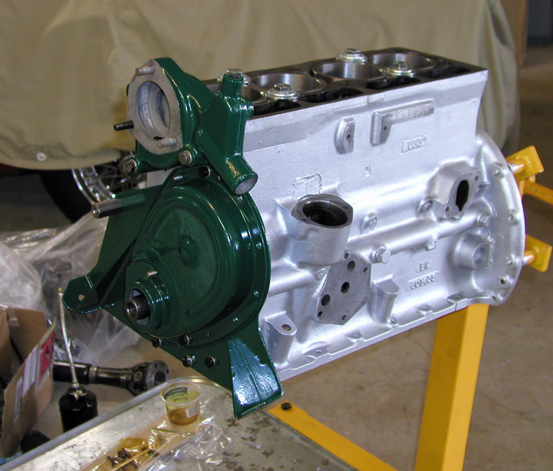

After the last thread on POR 15 I am a little hesitant to post a reply but I had good success with the POR 15 Engine painting kit when I did my TR6 resto about 4 years ago now. It has held up well over the past 4 driving seasons over 15000 miles.
Here is the Kit
You need to follow the instructions for prep carefully. Clean/Degrease/Clean with Marine Clean, Etch with Metal Ready, Paint with the Silver Por 15, Cover with the Black (or other color if you prefer).
Here are some pics in order of process

UmmYeahOk
This is POR 15, it was painted over the silver just like M. Pied Lourd did. I had a bad experience with Duplicolor engine paint. It probably was the clear coat we used (also duplicolor engine paint), but with the heat it turn my silver into gold, and my blue into turquoise... ...although Duplicolor still paid me $1000 for submitting great "before" pics anyway. (contest)
So we used POR-15 since we used it with everything else on the car. Havent had it running so Im not sure how good it is yet. Its the same stuff we used on my husbands porsche brakes, which seem to work out fine. However I am curious because the silver we used comes off on my hands, even dried for days. I had used it on my triumph brakes, and even backing in a 300 degree oven it still came off. However after 400 degrees it no longer came off on my hands. Then again, I had bought chrome rattle can panint that would do the exact same thing. Must be whatever they add to it. I just wonder how the red will stay, if the silver is like that
