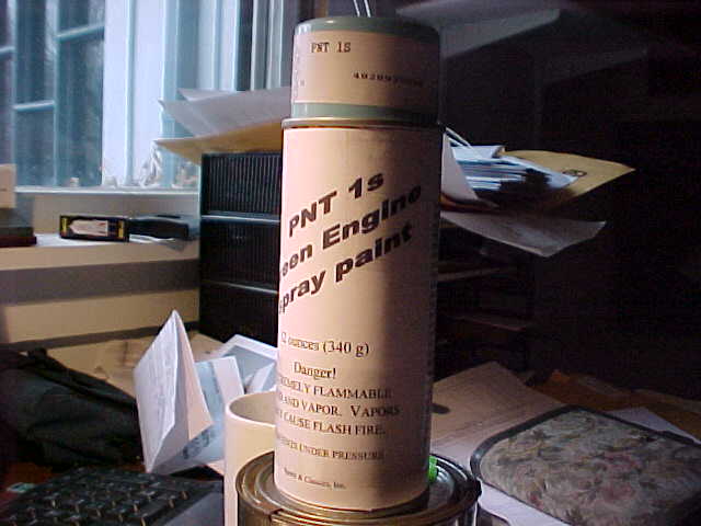

I'm trying to match the Austin Healey Engine Green color and was wondering if anyone has a paint code for it? I'd hate to have to bring in a sample of the Moss rattle can to be color matched. Who knows what variant I'd end up with. Anyone?

jeffs, sports and classics in stamford ct. sells it in quarts and gallons, 203-655-8731

The Moss rattle can color comes very close to the original. I've had cans that were purchased 4 years apart match each other perfectly.
Since it is a metallic, the final color/shade VERY much depends on the way it is sprayed.
Several very light coats sprayed with a little setup time between comes out much lighter than a wet coat or coats. The lighter shade is usually considered to be more correct.
D

Doug Reid, a.k.a "Mr. Finespanner," of 18G Motorworks of Maryland, claims that he has the most correct engine green. He says that Roger Moment bought several cans, and if you know who Roger is, then you know that that is a real testimonial in itself. You can reach Doug at mrfinespanner@earthlink.net for details. Tell him I sent you. (No, I don't get kick-backs, but I like to try to help magazine contributors when I can.)

Ok - after 4 tries I got an exceptional match to the Heaey Green engine paint with a PPG 2-stage paint.
If anyone wants the formula, I can provide it. No metal flake - lots of aluminum. You can get it in the DBI paint that requires no clear coat too

Ok, so I had paint mixed to match the Moss color and in the end it was slightly off, but in the direction of the Sports and Classics formula. Its for PPG 2 stage paint systems, available in PPG DUI interior paint as well, which does not require a clear coat!
I didn't realize until now that I don't actually have the formula, just a paint code for the mix, as bought from a local shop. I'll try to get it and post it here!
The same shop that mixed my paint had the POR15 engine paint in stock - their version of the Healey Green is more of a dark army green without the aluminum content that gives it the metalllic look. I'd never consider using it after seeing the color!
