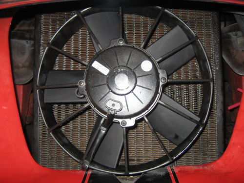

I experimented with those thin fans but they just never moved enough air...for sheer airflow I went with one of these big Spal pusher fans. This one is the 10" model. This fan really puts out the airflow and solved my overhheating problems. It is noisy, however.
