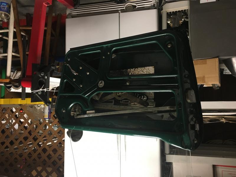

Everything went reasonably well, until putting in the window-glass. It rolls down smoothly for the first third, then it binds up. I can’t quite figure out why/where is is binding. Without the glass the regulator winds reasonably smoothly up and down.
Any thoughts? Did I mix up right/left window regulators? Is perhaps the tie rod installed incorrectly such that it is shifting the channels?

Picture attached ... no idea why it is upside down (would explain the binding :smile: )... preview looks fine, but I am sending this via my iPhone, and will revisit once in my real computer later this morning.

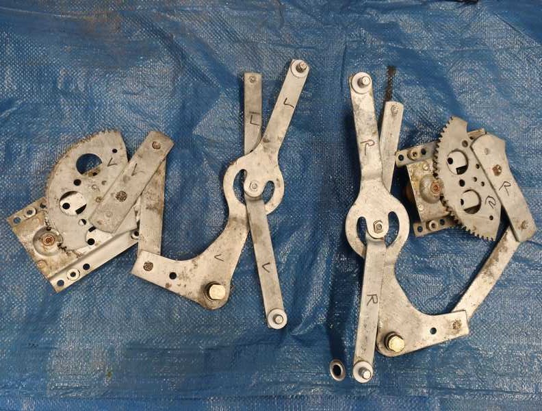

Is there a good way to discern left versus right regulator? I unfortunately did not label as well as I should’ve when disassembling :smile:
Sarastro
The left and right regulators are marked L and R in the figure, below. It's actually possible that I got them right...
You can see the bent arm on the left one; that's what I was thinking of in my last post.

So it looks like I have the correct regulator in the door - thanks Steve for the photo!
