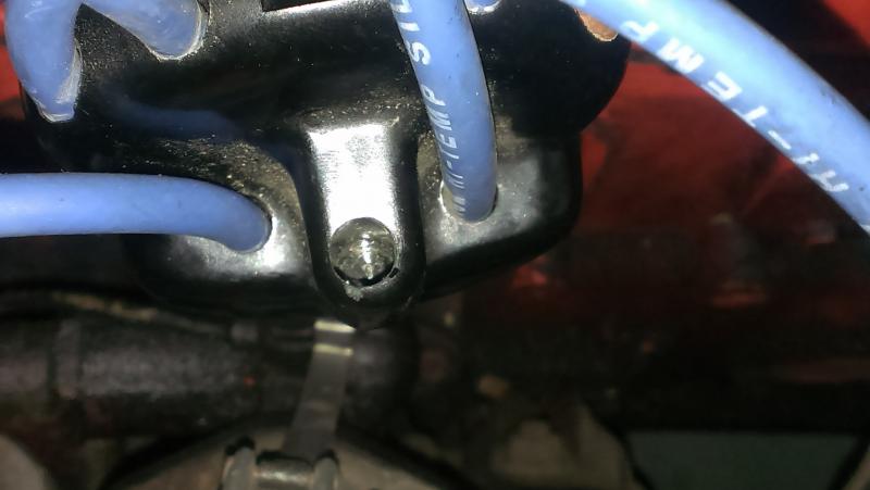

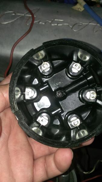

I have a 57 100-6 that isn't starting and while troubleshooting I noticed it had a random and weak spark. After taking the distributor off I pushed in the spring loaded coil pin and now it's stuck pushed in.
I can't get it to release to it's normal position, is there a way to fix this or do I need a new one? Also I see the plug wires have set screws but I'm not seeing how the coil wire is attached to the distributor.
And any other troubleshooting tips for what to check for not getting fire would be much appreciated.

The attachment for the coil wire is underneath the pin if I remember correctly. You need to bang the cap on a hard surface and hopefully the pin plus spring will protrude far enough for you to pull it out.
steveg
You have to get the carbon pin to protrude far enough to contact the brass surface of the rotor or the car won't run. Suggest spraying some WD40 and banging per above. When it protrudes, pull it out along with the coil spring behind it and you'll see the set screw underneath that pokes through the high-tension wire from the coil. Sometimes the little coil spring needs to be stretched so the pin sticks out of the cap far enough.

Thanks for the suggestions guys, I couldn't get it out and buggered the carbon pin trying, so I'm just getting a new one I found on Ebay for $15, I was surprised how many parts I found available on there.
Those type of caps with pointed-screws retaining the high tension wires were made for a true copper conductor, and do really poorly__and connections fail really quickly__when used with modern carbon-core suppression wires.
My recommendation would be to get you the requisite amount of good ol' warh, some terminals/plug boots and redo the whole works.
Be sure you are getting quality cap on Ebay. There are crummy ones out there. Some even say LUCAS on them. I've seen new ones crack or crap out in less than 1000 miles. Get one from British Car Specialist or Jeff at Advanced Distributor. You don't want to be on the side of the road with a bad cap. I carry a spare in the boot.

I barley tugged on that coil wire and it came out of the distributor, it has the carbon core wires. It makes sense it's designed for a copper wire so the pointed screw has something to bite into. I'm going to look for a copper wire set, thanks for pointing that out.
Don't know if this has been fixed - one problem with the aftermarket Chinese-made caps is the pointed screws are sufficiently off-center so as to fail to puncture the wire in the center and also fail to grip enough of the wire. This may be what happened when the wire easily pulled out. A friend had one of these and you'd shove the coil wire in with all your might and the screw would barely poke the end of the wire.
So inspect your new cap carefully.
Thanks for the tip, supposedly this cap is made in England so hopefully I don't have any issues.
